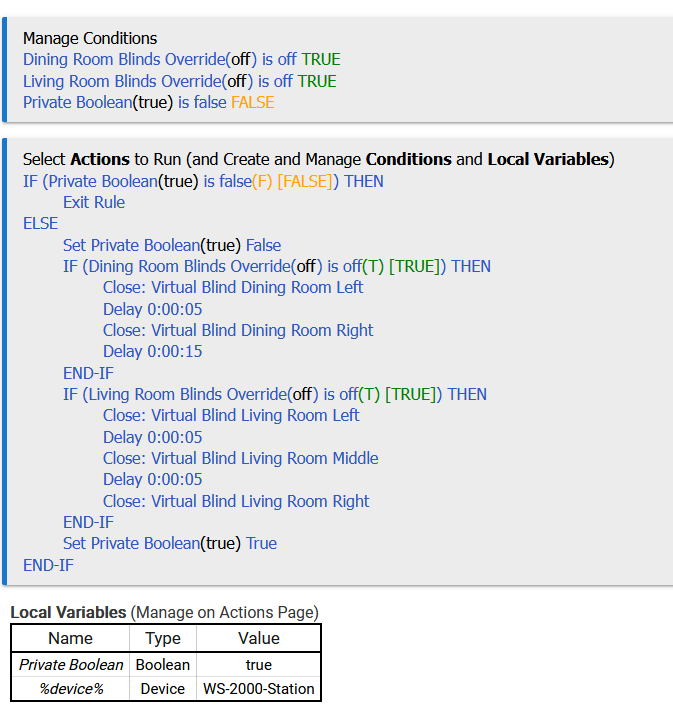

I found a workaround with a private boolean.
