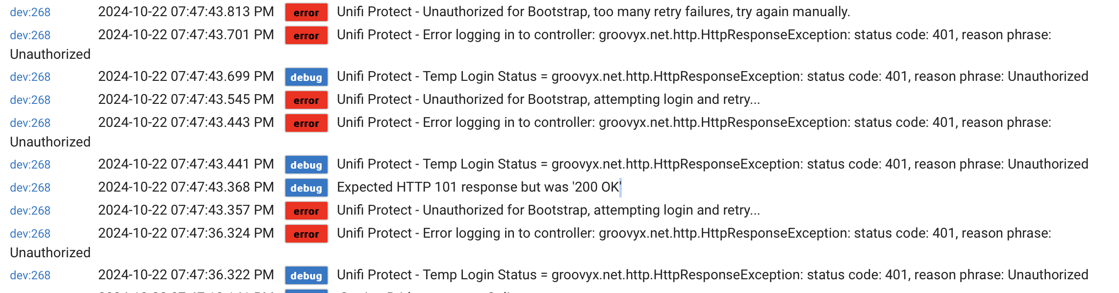

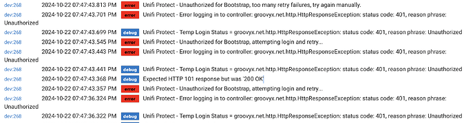

i was not using your drives. i removed all the previous protect drivers and installed the ones you listed. i created the virtual device but it fails login. i switched the port from 7443 to 443 and the type to other unifi controllers. that got rid of the connection error i was getting.
I've since removed all the drivers and gone back to [UniFi Controller Manager]. This is the only thing that allows me to log in and get any kind of data from protect. now that i have re-installed it the * smartDetectType : waiting is working

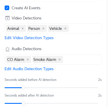

I am referring to your driver. I don't even know if it should work. It is a G4 Instant which isn't a super powerful camera. That said it does have support to recognize People, Cars, or Animals. Here is the setup option in Protect.
I am using the regular camera driver though "UnifiProtectChild-Camera"

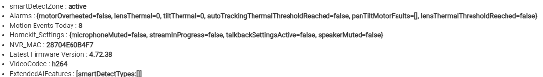

What concerns me is the last item in that screen shot. Was this added recently and maybe it just came in with old data?
Yes, this was very recently added as I saw it in some of the Debug logs I regularly check in case Ubiquiti adds new data reporting in that I do not already have recognition for.
I cannot tell you what it actually DOES though. I saw the log entry, thought it MIGHT be useful so put it as a State Variable (not an Event) until I determine it has no value or it should become an Event. I am not manipulating the value for the field at all. What is listed in there is what the API provides. On my cameras, I have the exact same information as yours, including on the G3 Instant that is not supposed to have any AI. My G5 PTZ (which definitely does, and regularly provides values for smartDetectType) is the same as well... so it does not appear to be what the camera is set for.
My current theory is it might be a placeholder area for when they add additional AI features in.

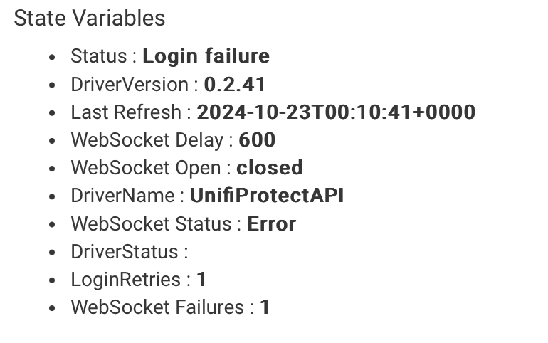

if i could get your drivers working i would be willing to try but i never got past creating the virtual device. it failed login. i dont know if this matters but im using a Ubiquiti NVR

I now have auth key successful but still have a WebSock Status Error.

As for login errors... couple things to try:
- Since you have a Ubiquiti NVR, the "Unifi Controller Type" Preference should probably be "Other Unifi Controllers". Once that is saved, the Port # should be either 7443 (usually older firmware) or 443 (newer firmware).
- Make sure you have a LOCAL user account with admin rights that you are entering for it. It will not work if it is a cloud user account using MFA.

I'm getting there. I have to have webSocket disable, Unifi dream machine selected. other settings throw authentication and connection errors.
Once i set that i seen the cameras get detected in the logs.
