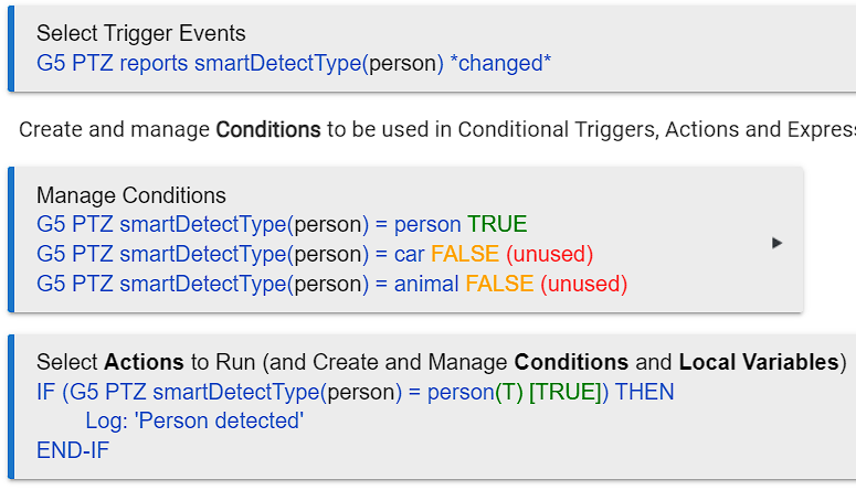

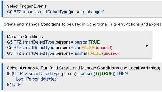

Maybe I'm missing something but i cant seem to figure out how to get the Protect notifications for AI. if the camera detects motion i have a rule that turns on the external lights. I want to shut off the motion in the camera and only use the AI (Car, person, animal) detection. how can i use these triggers to do the same thing as the motion.
You should be able to use the "smartDetectType" attribute. Something like this:
this looks like what i need but i dont have anything that look like smartDetectType
