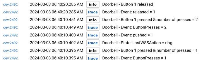

The doorbell was not showing 'Button X pressed' messages. Today's update has them back. But no 'pushed' events.
And the websocket messages are gone now too

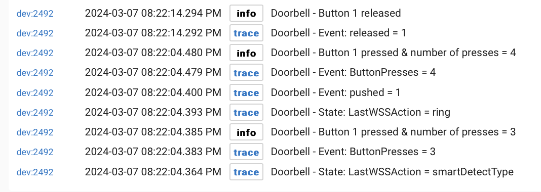

WebSocket are gone because they are being handled. There is a pushed event at the very middle 8:22:04. It even got the "released" event from the doorbell as well (that is one of very few button devices I have ever been able to code that in for).
Are the pushed events not showing in the Event log? Because that one looks like it actually did get caught.

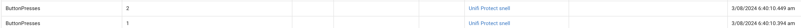

Correct, they show in the logs but not in the events. This was the situation when you first re-worked the push logic. The doorbell is a Pro POE model.
Another set of logs, with events this time:
