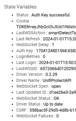

I am unsure if it's the individual device or just saving preferences that forces the events to start reporting again. There were no events being reported for devices until I saved the preferences on one of the devices. Afterwards it started reporting events. I'll do some more testing and see if I can reproduce the exact steps that cause it to happen.
Latest versions of both:
Unifi OS: 3.2.7
Protect Version: 2.10.11
I have had them both running on my hub for over a year and hadn't observed this behavior previously. No issues with hub load either before this week, but I wasn't really using a lot of the functionality of the drivers yet.
If you manage to reproduce it on demand, I would appreciate it. That should help figure out what happened.

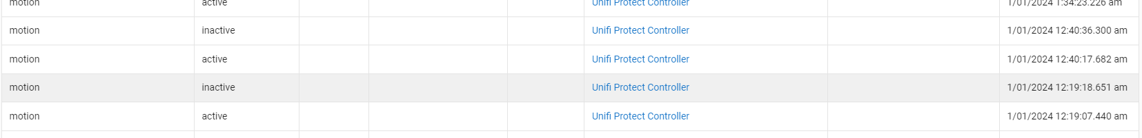

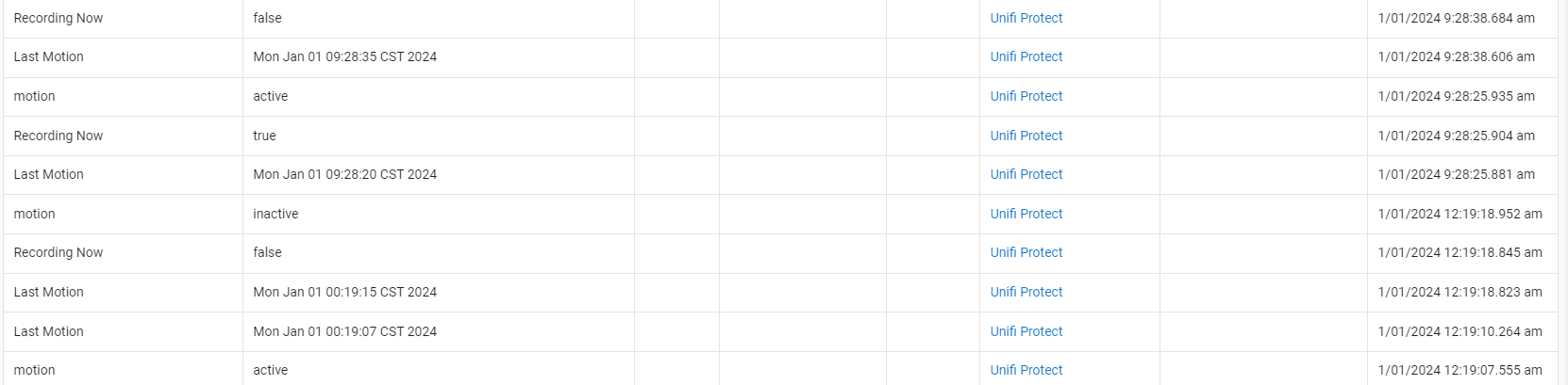

What I have observed over the past week is that your driver will stop creating events for some time and then will restart creating them (see the screen captures below from tomw's driver vs yours). This is happening on the camera and doorbell device types.
snell's driver - gap between 12:19 am and 9:28 am
tomw's driver - events were captured/reported between 12:19 am and 9:28 am
When I look at the parent device I do not see any issues/failures. NOTE: The screen capture was not taken during the 12:19 am to 9:28 am window. I will try to capture a screen capture of the parent device during a time when it is failing to create events.
Not sure how/why that would happen. There is nothing I specifically schedule during that time and I use almost identical websocket code as @tomw's (mine was copied from his with permission) and has only added some extra devices and responses discovered since. My EVENT code is different but the main thing there is that it checks to see if something changed before posting the event (or not) OR it is a forced event (always posts it regardless if it is a changed value, but these are not set to be forced).

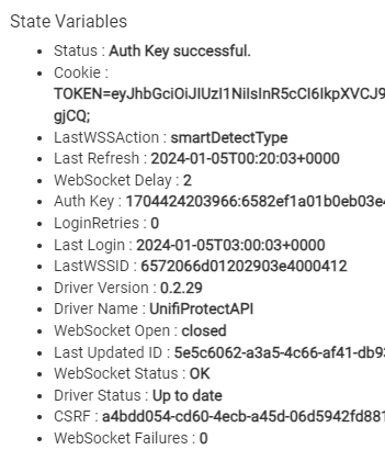

I was just checking on the device again and I noticed that events were not being created after 3:18pm today. Below are the current attributes for the Unifi Protect parent (WebSocket Open = closed) now. During this time window, tomw's driver has been creating events.
I see the following in the logs:
I can turn on trace if needed.

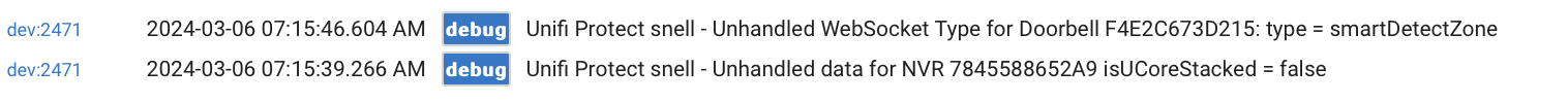

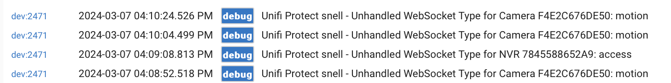

Something is just not working correctly. The doorbell is not registering pushes still. And the doorbell stops logging any events. A Refresh on the parent re-starts the event logging. Here are errors from debug. Note the camera with errors is a G5 bullet, not the doorbell.
These are not errors. This is just logging of stuff I do not have code for, basically stuff nobody has sent me a sample of before. Plus, as you mentioned, they are unrelated to the doorbell.
For the doorbell child, there should be Info logging that shows stuff like "Button 1 pressed & number of presses..." Is that showing up at least? Out of curiosity sake, what type of Doorbell is it?
I am publishing a new version to handle those new WebSocket types at least...
