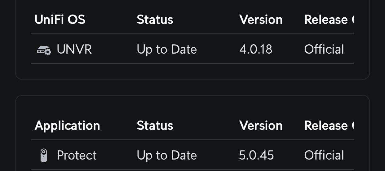

The smart detections aren't working for me either. Every once in a while they show up, but not often. They do show up in Home Assistant. I'm on the EA channel, Protect 5.0.47, Camera 4.72.44

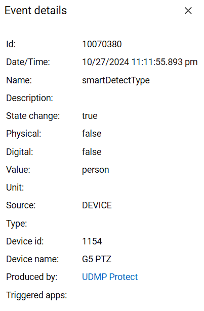

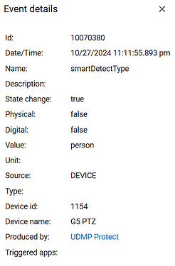

The attribute would be named "smartDetectType". Here is the screenshot from one of mine:

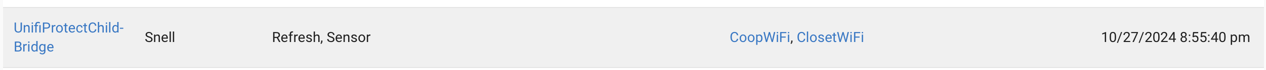

what does this driver do?
the 2 wifi things its listed are not cameras. not even nvr or cloud key devices.
Hmm... not sure why the Doorbell would not be providing those events. Does it provide a notice if the doorbell is rung? That should also be a WebSocket activity.
The Bridge driver is... mostly useless. I have debated about discontinuing them. Basically, it creates a device that represents the Bridges that your controller is using to act as an intermediary for the Protect devices. These will typically be some (not necessarily all) of your Access Points. They provide some VERY limited information... but you can do a lot more with one if you are using my Unifi Network drivers to control them. The Protect API just does not allow for much with a Bridge. I originally added them because they WERE a device being provided by the API (and someone may not be using my Network driver) and I thought maybe Ubiquiti would implement more for them in the future (which has not happened yet).
