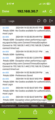

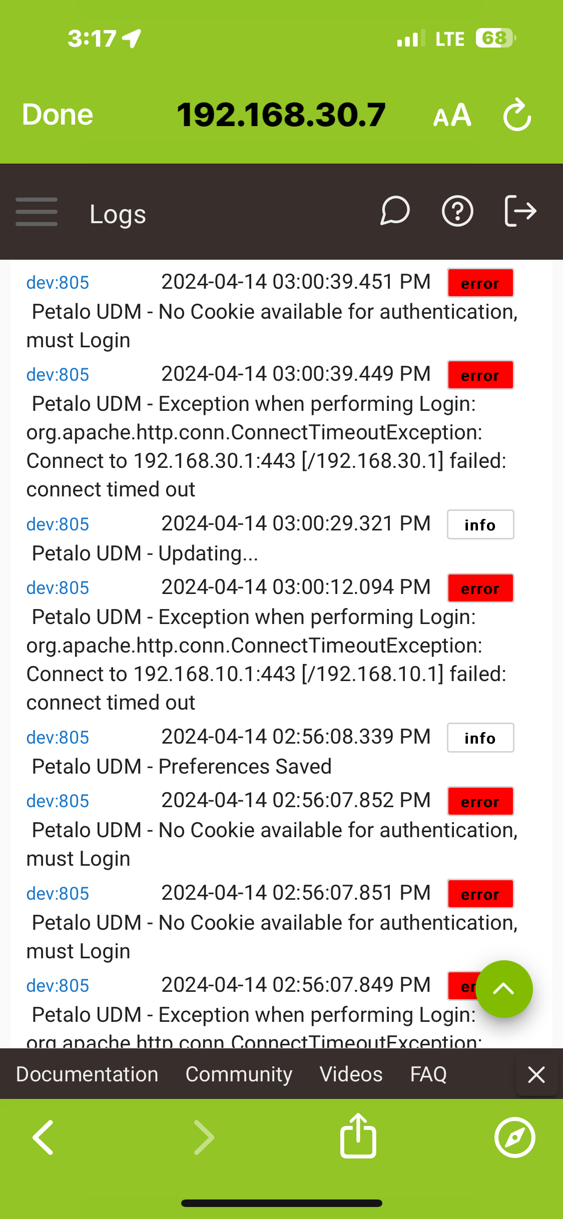

Hello all. I really like the sounds of this app but have run into a problem. After downloading, installing, etc per the guide I can’t get logged in. I repeatedly get a “no cookie, please log in again.” It’s probably something basic on my end I’ve overlooked. If anyone can help out, I’d really appreciate it!
TIA.
Do you have two factor authentication enabled on your controller ? If so, you will have to create a second login that does NOT use 2FA. Then use that login in the Hubitat APP.
Well, I shouldn’t do Hubitat stuff when I’m tire. All I needed was a local account on the UDM and an allow rule in my firewall.
