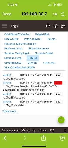

I’m sorry to sound like a fool here but I need some more guidance, please. I’ve added the UDMPSE child device but cannot seem to get the states to populate. Any guidance would be tremendously appreciated!

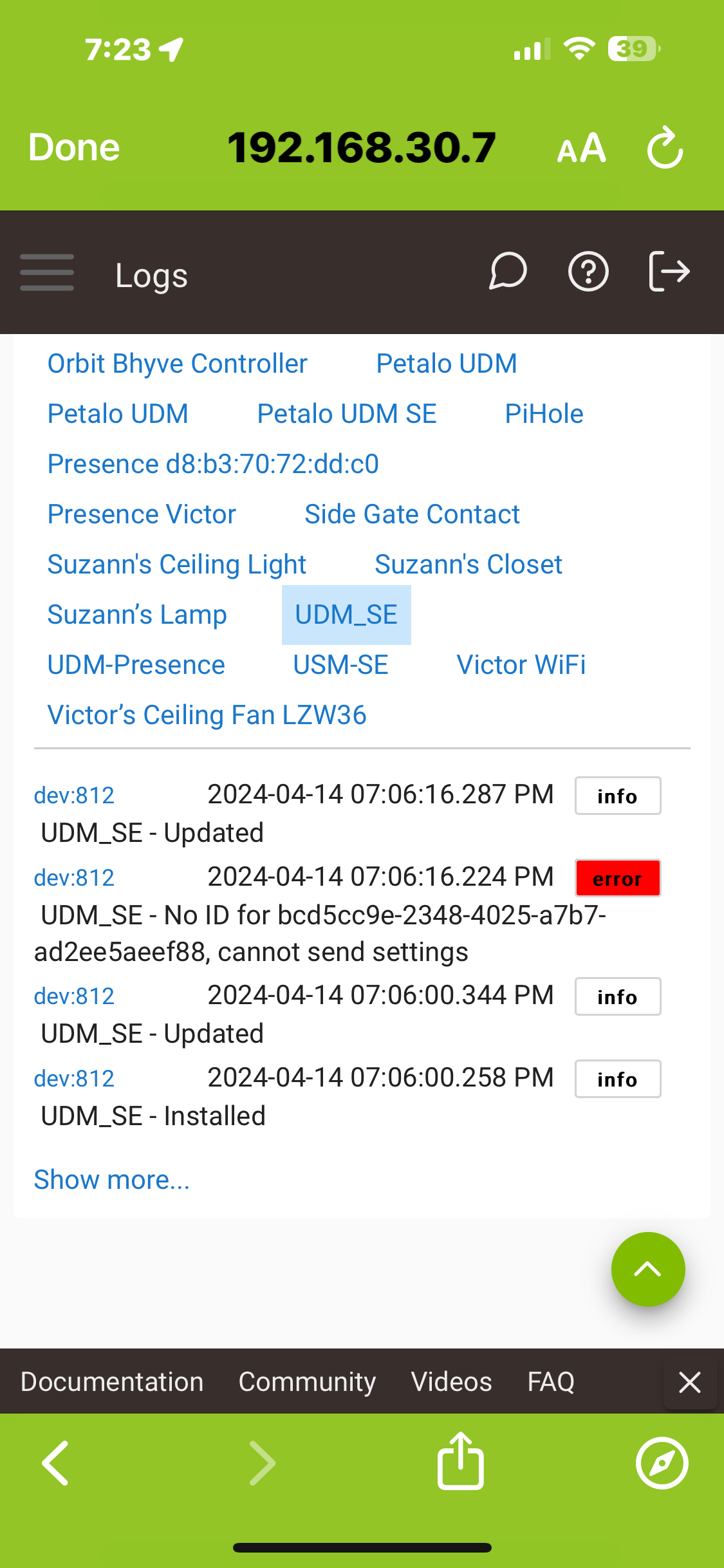

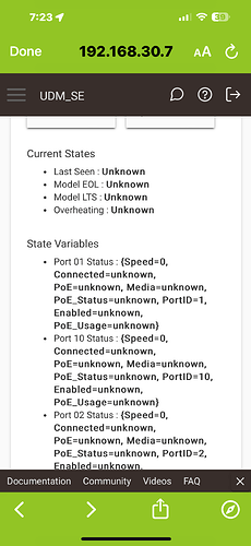

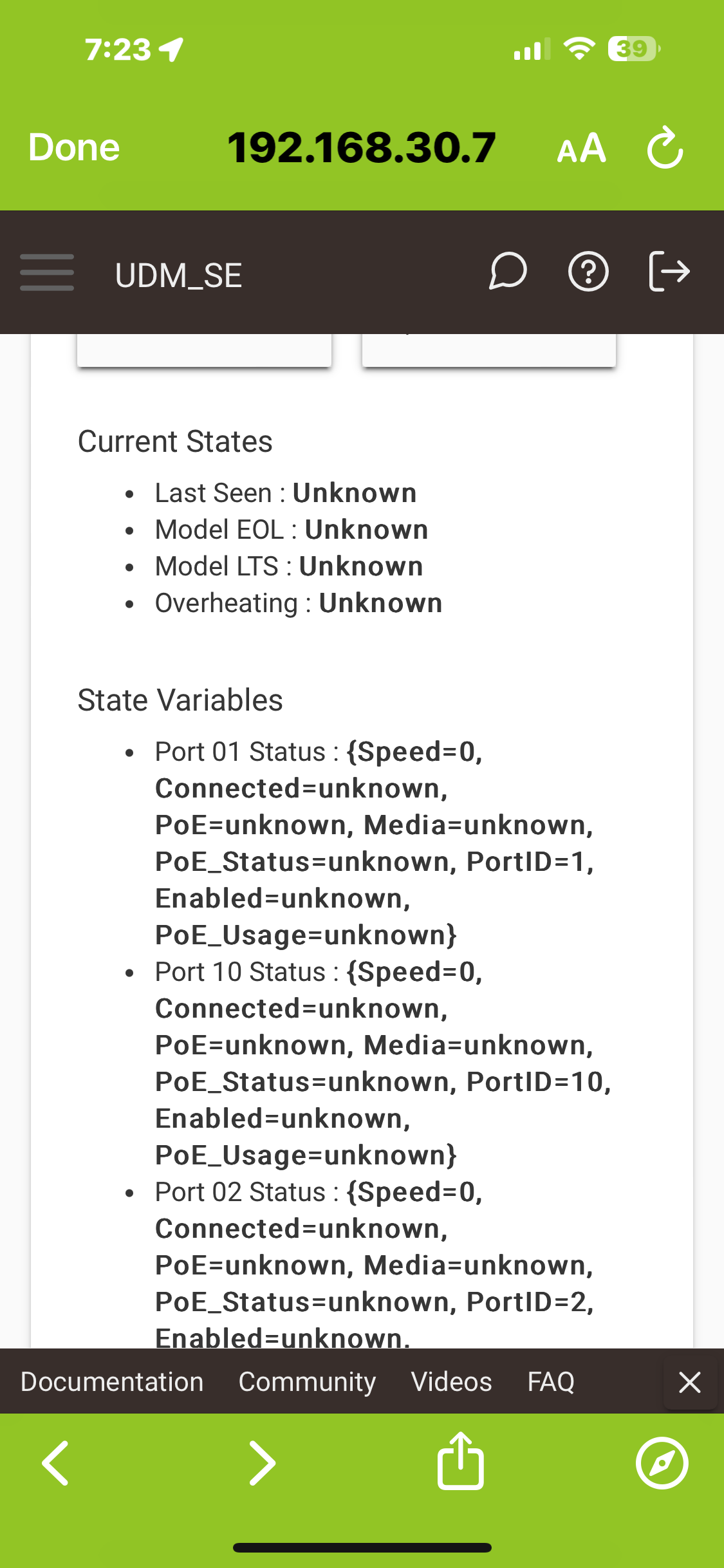

@jvwilson101:
Sorry I did not see your post before now... did they eventually update? You should never add a child device manually (they will never get data). All child devices will be created automatically by the parent device when it receives information for them. From the second log image it looks like there are multiple things that are in here that have Unifi designations.
The only virtual device you ever need to create is the one for the parent.

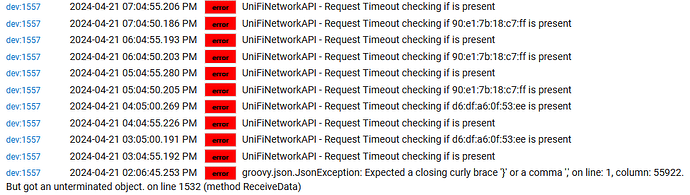

@Busthead:
It looks like the first thing that happened was it choked on the data that got returned from something. Do you know what was scheduled that might have happened at ~2pm? Some of the rest appears to be the infamous Request Timeout for presence checks... but you also appear to have a lot where it did not list what it was checking, almost like it got a null in there.

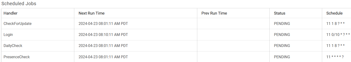

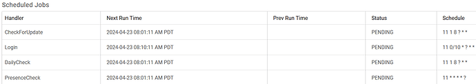

Scheduled?
This is the list of MAC addrs to Presence Check:
f6:98:05:7F:90:33;76:7a:67:c8:84:48;90:e1:7b:18:c7:ff;;d6:df:a6:0f:53:ee;6c:72:e7:9b:f3:c6
Your MAC Address list has a "gap" in it (double ;; after the 3rd one) causing the null:
Should be:
f6:98:05:7F:90:33;76:7a:67:c8:84:48;90:e1:7b:18:c7:ff;d6:df:a6:0f:53:ee;6c:72:e7:9b:f3:c6
I guess I should build a check in to reject checking for ones without a full MAC address... thought I already had that but maybe I forgot to ignore a null entry.
As for the scheduled part, at the bottom of the parent device page there is a field with "Scheduled Tasks" that say when things should happen and when they last happened. Curious if there is anything (besides PresenceCheck) that might have happened so I can see what overloaded the ReceiveData.

@Busthead:
The timing is close enough that your Unifi API could have been "busy" while processing and providing all the stuff for the DailyCheck to get those Request Timeouts. Not much can be done about that but it is STILL something I am trying ideas with.
The number of devices is not bad (I have 17 Ubiquiti devices) so I am not sure what might have pushed the limit on the returned data. Does that error happen every day (so it is being caused daily with the DailyCheck data dump) or was it just that time?
