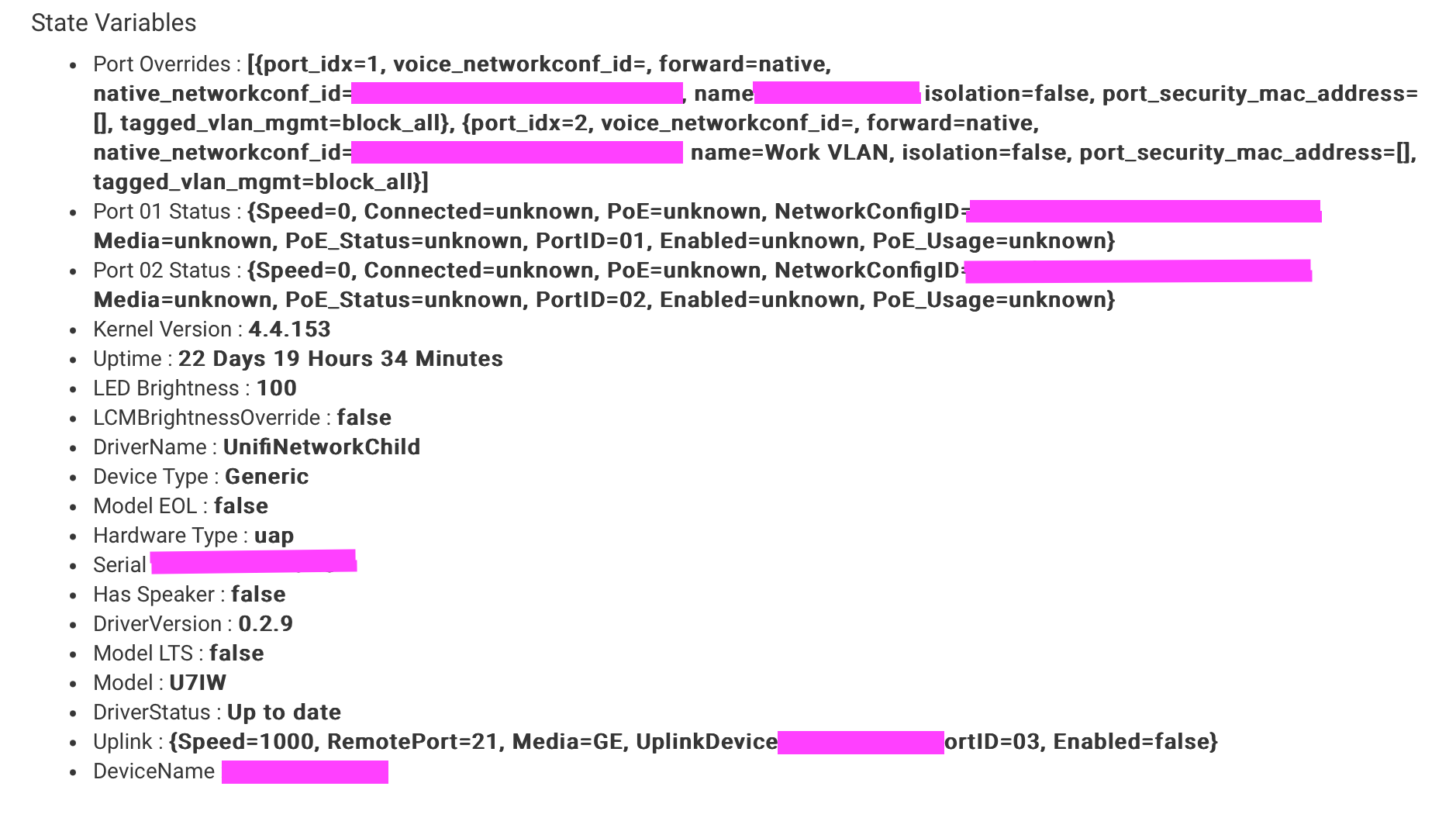

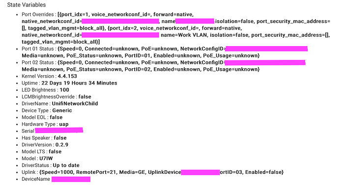

I noticed on my 'AC-IW' access point it shows up as a generic child device. I thought before it was showing up as a normal AP before.
I looked through the driver list at the top of the page here and sure enough it shows up as the AP that I had selected. I deleted it and refreshed the devices to load it again and it still comes up as a generic device. Not sure why that happened and if it is a change or not.
Here is a screenshot of what it shows today as I did not pay attention to it in the past to say if this is a changed behavior or has always been there.
No rush on getting the driver added / adjusted. It can be done whenever you have time and are ready to make it available. I appreciate your work on this project. Also here is the 'Tech Specs' on the AP in question: AC-In Wall
I am pretty sure I do not have any recognition built in for the U7IW yet, so thanks for the info. You might have better control if you switch it to the existing in-wall driver for the UHDIW (I have one of those myself). I will check the specs to see if it looks like it needs a different child driver made or it can stick with that one (like many of the APs share a driver).
EDIT:
Ok, so the AC-IW is the original in-wall AP prior to the one I have (which the labeled as the U6IW but has a model of UHDIW). The U7IW made me think it must be some new model that just launched supporting WiFi 7. From what I can see of the specs it is very similar to the UHDIW BUT only has 2 output RJ45 ports (but the same only-one with PoE). I hope to post a new child driver for it and update the API to recognize it shortly...

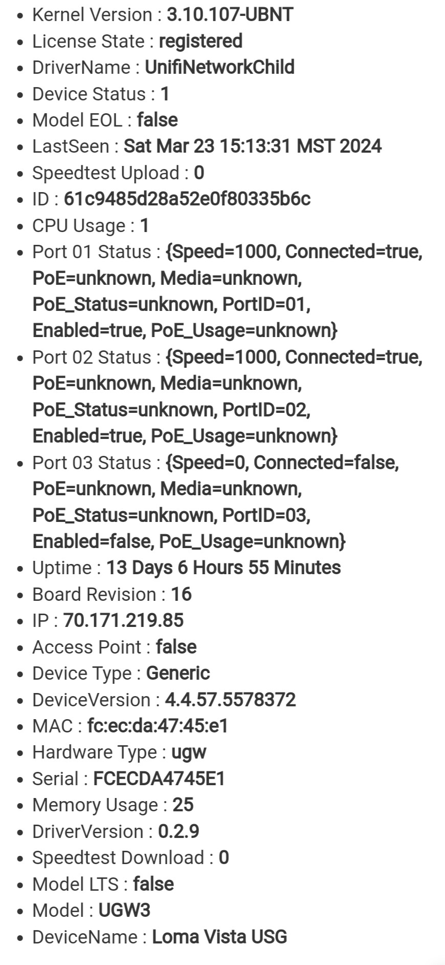

I noticed just now that my old USG is detected as a generic device even though there is a specific driver for the USG. If I let it detect and install the generic driver, I can change it to USG and it gives me a few more options (like locate device options). Could the main driver be updated to properly detect and install the correct USG child app instead of the generic child device?
I thought I had that already... can you confirm what Model it shows in the State Variables? I am out for the evening but it SHOULD be a quick change in the morning when I get on my computer.
That explains it. The model shows UGW3 but the recognition is for UGW4 which is the only one I had seen before.
Updated Version(s):
  • UnifiNetworkAPI.groovy = 0.4.61
  • UnifiNetworkChild-UGW3.groovy = NEW, added to list in first post
Change(s):
  • Added recognition for UGW3 to main driver and created a child driver for it since it is different from the UGW4
