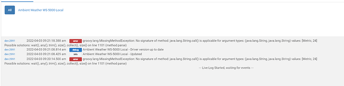

With the 0.7.14 driver, I'm seeing this when selecting 'Save Device' and (it appears) during every reporting interval:
Looking into it... It looks like the distance value (the 24) it is receiving is counting as a string NOT as a number... and the ConvertMiles needs a number. Trying to replicate it on mine to see if the fix is as simple as making it (except I do NOT have an Ambient lightning sensor, so I have to fake it):
ProcessEvent( "Lightning Strike Distance", ConvertMiles( "Metric", ( it.value as int ) ), "miles" )
Or if that will introduce bigger problems...

  • Correction to LightningDistance section to handle when the value is returned as a string not as the expected number. While I do not have one of these personally I threw a bunch of samples at the conversion and think I have a good solution (having it convert the value using "as float").
Just tried the updated driver and indeed the errors are gone. Also the proper converted value (14.91) now appears instead of 24 in the device details page.

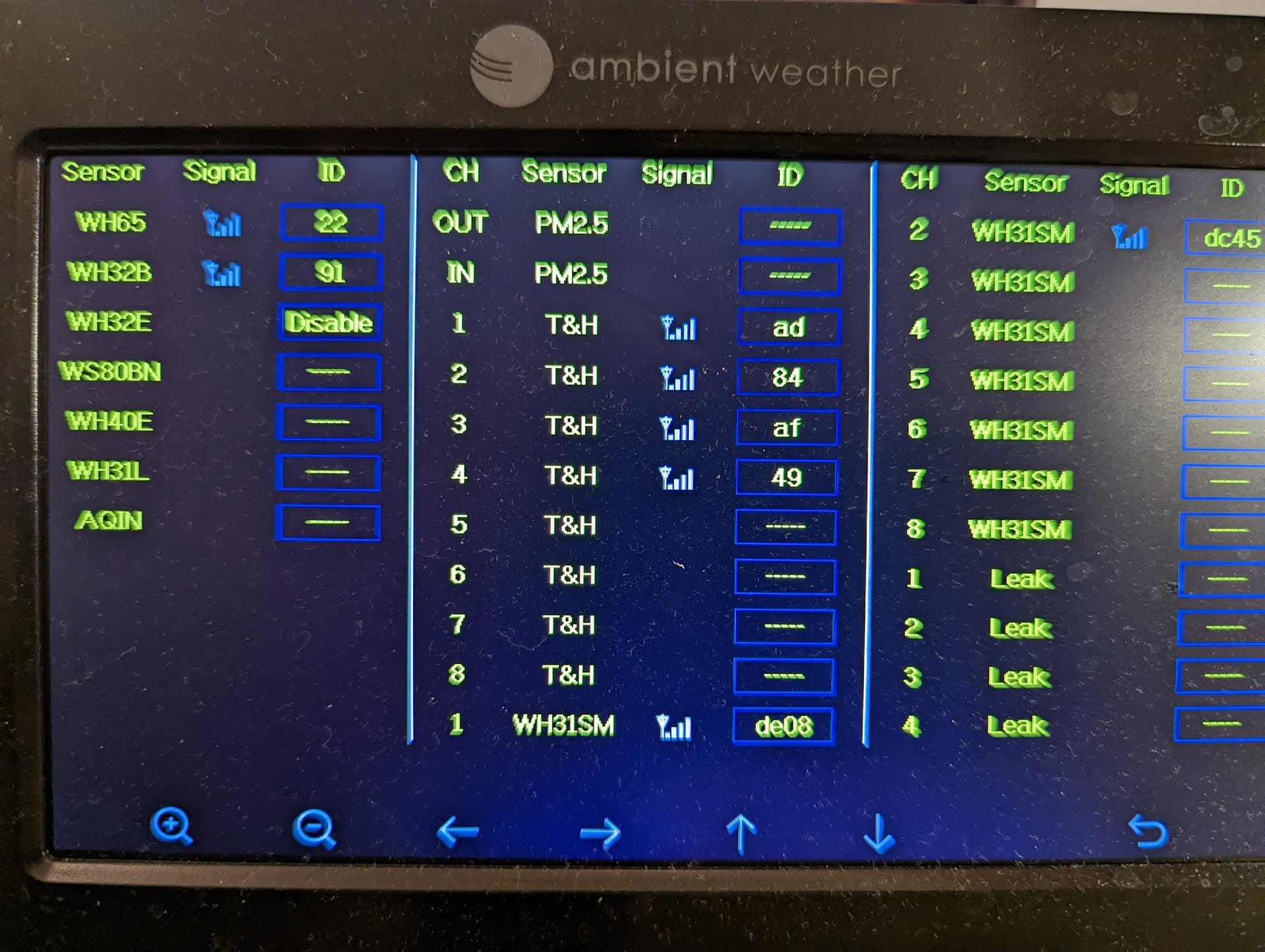

I just added two of the soil moisture sensors (WH31SM) to my WS-2000. I thought these would appear as child devices. But it looks like the code isn't recognizing them correctly and putting the data into the temperature sensor N for soil moisture sensor N.
The local API only reports two items: the humidity the sensor detects and the battery state. E.g., this:
soilhum1:98, soilhum2:89, battsm1:1, battsm2:1,

Does this work differently in past devices, or with the Ecowitt gateway?
That's not how I see my WS-2000 reporting in the API and on the console!
The WS-2000/5000 It can have 8 temp humidity sensors, and those are separate from the 8 soil moisture sensors. working.
You can see the 4 T&H sensors in the output I included in the previous post - temp1f ... temp4f, and those are separate from the soilhum1 , soilhum2.
