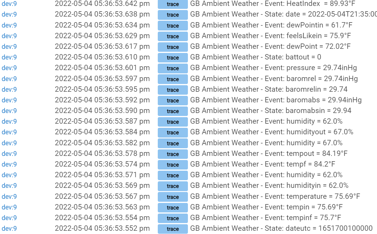

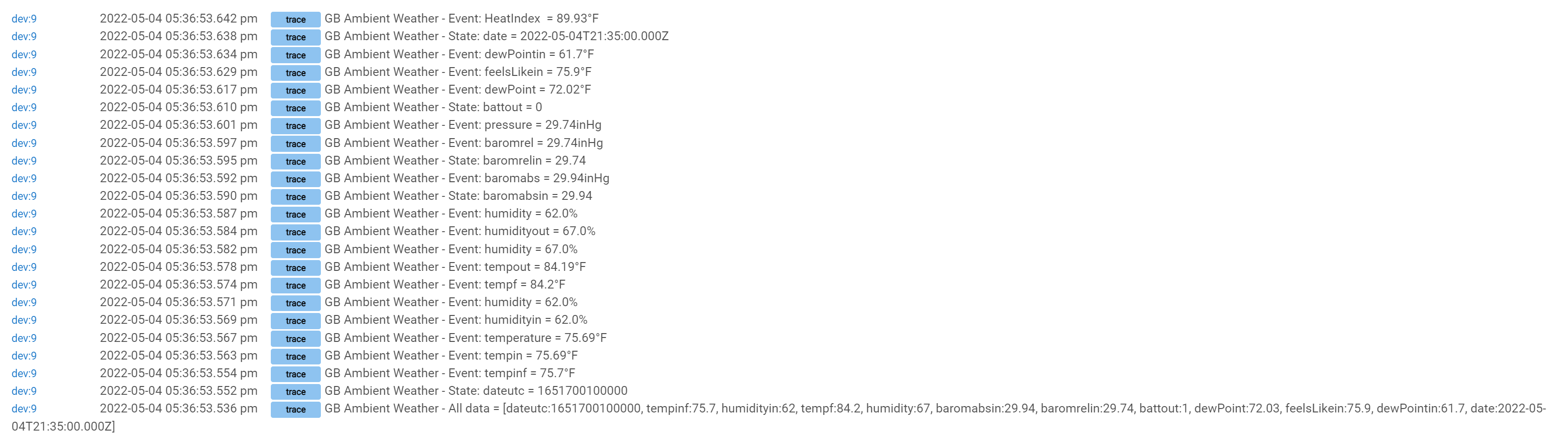

Finally looked at a full trace on this humidity thing. It's interesting that the "event" humidity moves from humidityin to humidityout and back to humidityin. This doesn't seem to be happening for other variables.

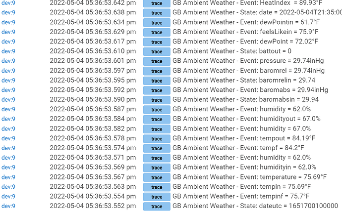

Easier to read . . .
Well, that is all part of one data push so I cannot see how it is an API-side thing. Not sure how it is happening but I will have to find a way fake it on my side and see if I can figure out a fix.
Thanks for this, it helps... The really odd thing is the 67% humidity BEFORE the humidityout... since it should get the humidityout and set that before it sets the humidity, but only based on the Preferences. For some reason it is acting like the preference is not set maybe? Not sure. Either way, something for me to dig into.
FWIW, the prefs are at least set in the UI. See below. I've changed them and re-saved them several times.
EDIT: Found the bug... I feel really silly having missed it... the problem was that outdoor humidity is reported as "humidity" and indoor humidity is reported as "humidityin"... but in almost all cases I post an event based on what the key is so it was using the humidity key. Basically duplicating. So I changed it so that it now calls it humidityout for that specific event.
I also moved the check for which humidity to report towards the end once all the data should be in, rather than while it is running through it.
