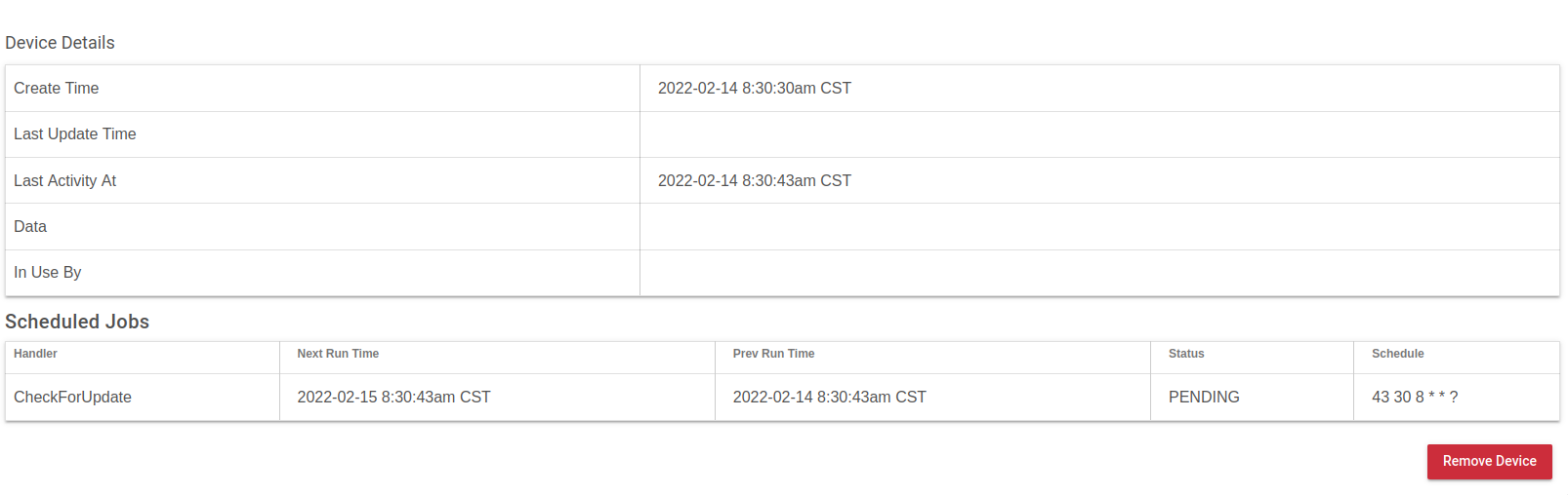

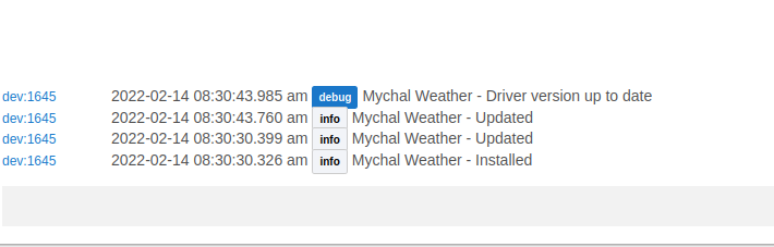

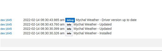

thanks for the step-by-step. Still not getting any data coming back. I have uninstalled the device, driver, and reinstalled, etc. On local, logs are saying the weather has been updated, but no data is coming back, and getting this on the pending schedule... which does not seem right in some way.

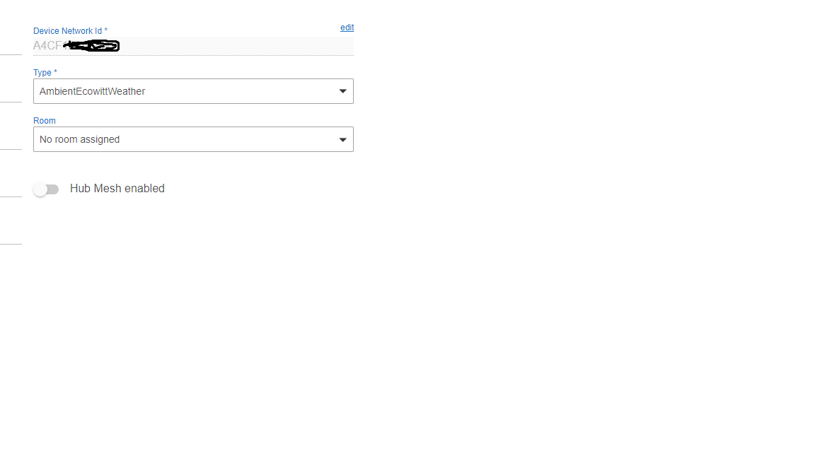

Mine didn't work until I changed the DNI to the Ambient's MAC address
DNI is input, without any : or spaces. I have tried both lower case and all caps.

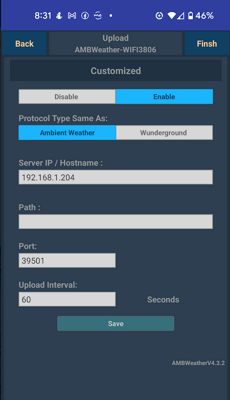

ok, thanks to the screenshot above, i got it working... .path was needed I guess. /data/report/
I am suspecting that path needs to be at least a bare "/".
(and when I set mine up, I didn't realize I could do it via AWNet; it would have been easier)
I will make a change to the instructions to make sure people leave the path at the default. Good to know something is required there AND that you got it working.
As for the Scheduled Jobs, that is all you can expect when using Ambient Local (or Ecowitt). The station (or gateway) itself sends the data to the Hubitat so there is no reason to schedule a poll of it (like is needed when using the API method). So the only thing that gets scheduled is the daily check to see if there is an updated version of the driver available.
thank you sir. Appreciate the help and sorry it was taking up all this time in the thread. Just so you know, I did not have anything in the path area on AWNET, and did not remove anything, so, when the instructions said "leave it alone", as you can see in my screenshot above, I left it blank. No worries though, I am extremely happy to not have to rely on outside forces to update this info. It messes with home automation as I use the illumination sensor to turn on lights when it gets dark. and this is not the first time that the API has been messed up, but I think it is the longest outage that I can remember.
