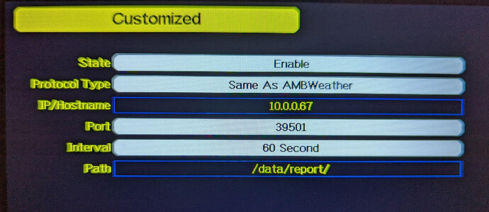

It required me to set this on the WS-2000 console (the IP address is that of my hub).

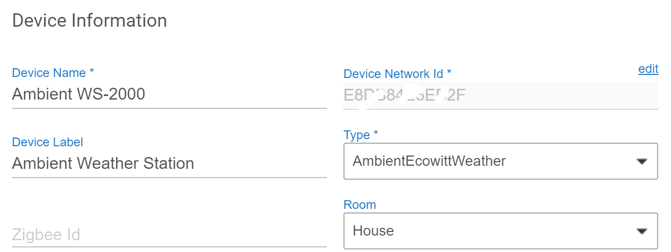

And it started to work when I set the DNI to the MAC address:
