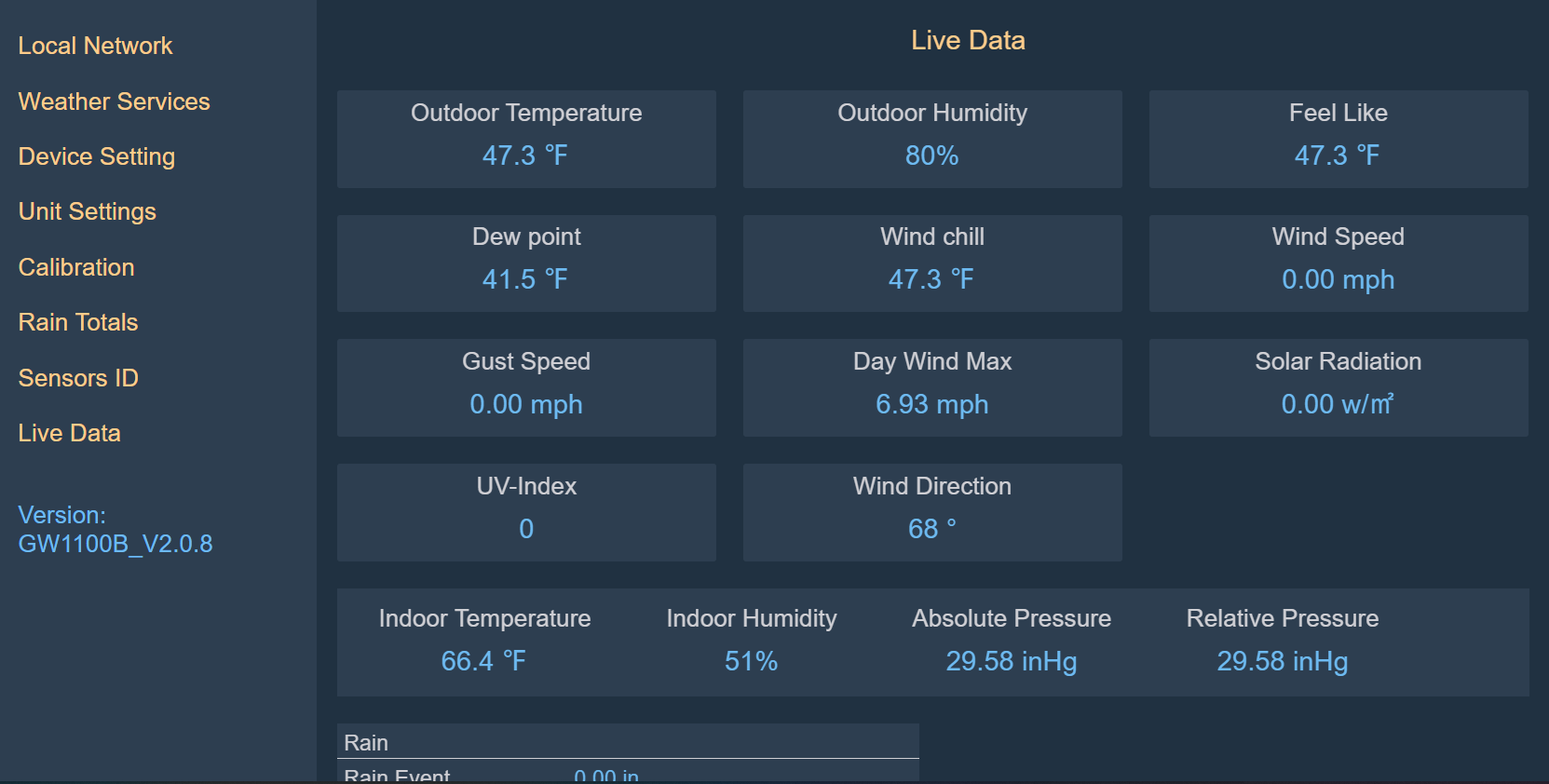

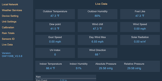

You can add the Ambient Weather Station to the Ecowitt Gateway, and then the Ecowitt Gateway can serve up the data from the station.

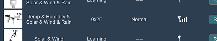

Looks like this in the Gateway:
Live Data:
My PWS (WS-2902C) in the Ecowitt Gateway device list:

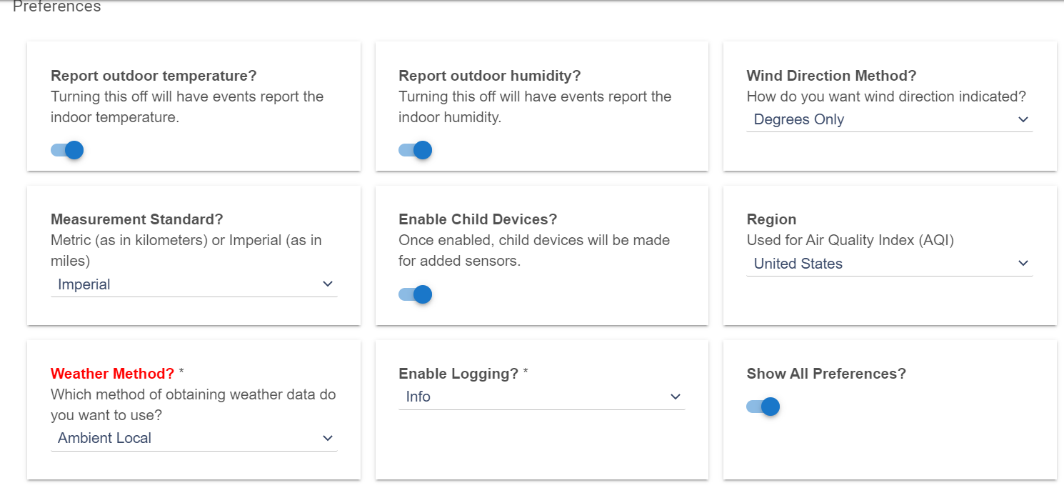

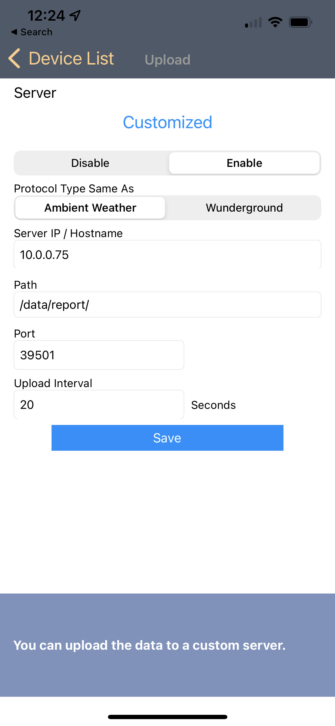

When I select Ambient Local as an option it hides the preference input option for MAC address. Is this intentional? I input the Hubitat IP and specified port through the awnet configuration app.
@beachmoney - you add the MAC address into the "Device Network ID" field.
If you look in the comments at the top of the driver, it has really good instructions.

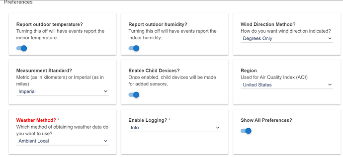

Wanted to try out the local direct to Ambient WS (WS-2902C) but I think I'm misuderstanding the setup. I've configured (I think) properly. I've set the DNI to the MAC address of the Ambient station.
No child devices created. What am I missing? (I'm prepared to slap my hand to my forehead.)
@danabw:
The main portion is the app setup to make sure that not only is your Ambient at the right firmware but that it is uploading the data at the Hubitat. Amusingly it is all basically the same as if you set up an Ecowitt Gateway. If the MAC is set (remember, just the letters and characters, no : or other separators for it in the DNI) and the app has set it to send it... it is pretty well set.
You will likely only see two child devices created. An Outdoor Station (plus ID) and an Indoor Station (plus ID). Your preferences all look correct to me.

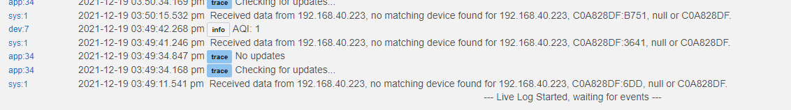

I updated the DNI to the devices MAC address and still no dice. I started seeing these in the logs:
which is not the MAC address of the device that is shown in my router, or on the back of the device itself. Not sure what that device is. I changed the DNI to be the 7 digits before the colon and it is updating correctly now
Not sure how they go about sending the data to it... but glad it worked. The MAC I had used was the one displayed in the Device List in the app.
