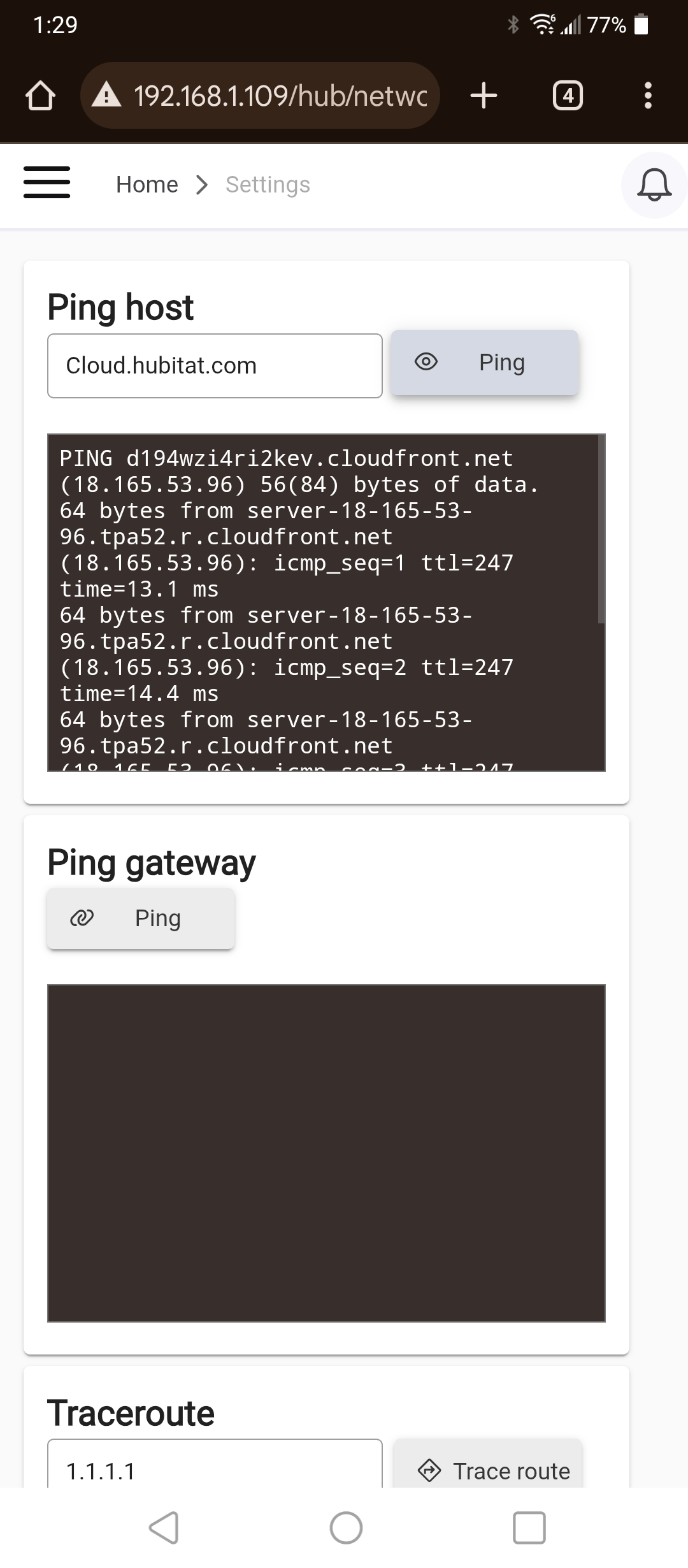

What does this test show
I tried both 1.1.1.1 and cloud.hubitat.com that's shown on your screen print. Both said "Ping failed".
If ping 1.1.1.1 failed your router must be blocking it (firewall) or your dhcp is not giving out a/or correct default gateway. Does ping gateway work?
