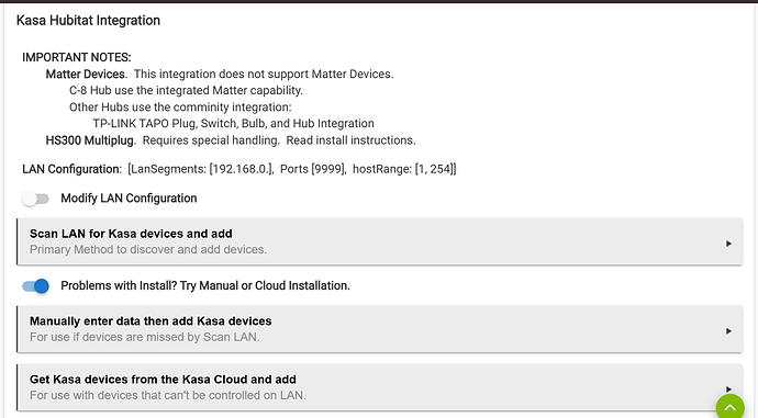

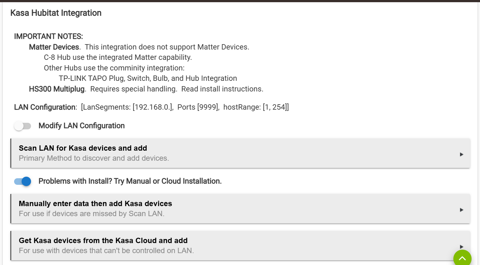

What are your LAN settings in the app itself? Show a screenshot of your settings.
I believe its the built-in Kasa Integration.
Are these the settings you want to see?
Yeah looks right according to your other info supplied.

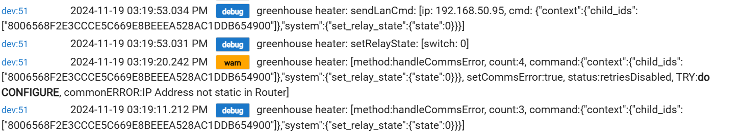

Only other thing I can think if would be to turn on debug logging for one of the devices, and then fix the IP again. Then to go logs > schedules jobs and find the scheduled task to turn off debug logging (usually 30 mins) and remove it. So that debug logging stays activated.
Might catch something in the logs when the IP switches back?

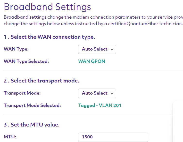

You are showing two different ip ranges. Do you have vlans enabled?
Unfortunately I'm not knowledgable enough to understand that, but it looks like I do? I don't see an easy toggle for that but am googling. Or I guess I can just select "Untagged"?

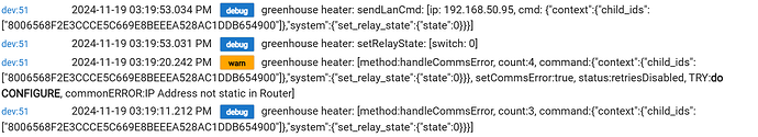

Ok, the debug caught the switch this time:

Yeah agreed, those logs seems to be showing first errors reaching the device, then I think the driver/app is trying to find it by running a configure. Somehow it is landing on that .50.95 IP, which must be coming form the LAN somewhere, it would not just make something up.

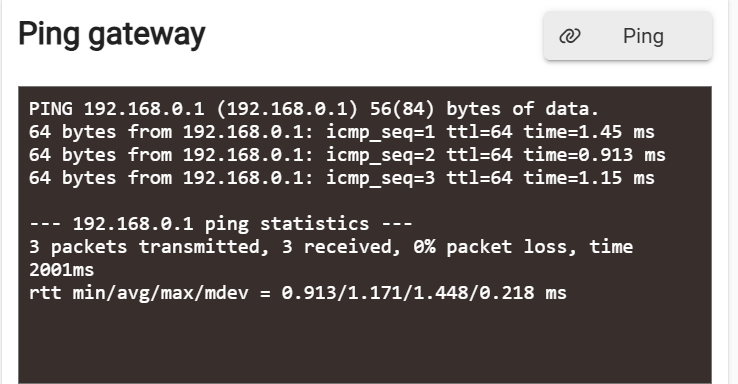

Lastly, can you go to the Hub Settings > Network Setup and tell us the IP of the hub, then click on Network Test and run the "Ping Gateway" and post a screenshot of that. All of that IP info is generic LAN IP addresses, so no harm in sharing on here.
Ok. I have unplugged the POD so now my system is the Quantum ONT, which is a c5500XK paired with their access point/router which is a w1700k.
Hub's IP addresses are 192.168.0.23 (Ethernet), 192.168.0.29 (WiFi - anonymous) via DHCP .
Here is the Ping Gateway results
