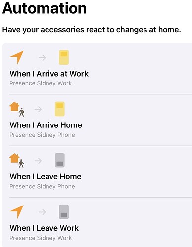

I am using Apple Home's built-in geofencing feature. I simply created a Virtual Presence with Switch device on my Hubitat hub. Then I exposed this device to Apple Home using Hubitat's built-in HomeKit integration. I then created two Apple Home Automations, one for arriving and another for departing, that simply turn 'on' and 'off' the Hubitat device. For this to work reliably, you will need an always on device on your home network that can act as an Apple Home 'Hub', like an AppleTV or HomePod Mini.
This has been extremely reliable for us.
You can also use Locative, as it works very reliably as well.
I use hubitat to present a virtual switch w/ presence to homekit. I use homekit to turn the switch on/off when i arrive/leave a location like my home.
For me it works 100%, easy to setup/test, and no extra apps needed.
Before that i used smartthings arrival sensors, as long as you have a strong zigbee mesh they also work 100%
Heck I brought in Home Assistant and BLE beacons to get presence sensing working reliable. I've had to set up ESPHome and then set up a whole bunch of BLE proxies around my house to make sure I got coverage for the beacons all over my house. It has been a huge pain in the butt. But it's also quite reliable now.
Ditto. Bigger plus is you never have the apple tracking warnings and periodic 'need to accept' like all other 3rd party apps require. It just works.

Same here - I use virtual switches to HomeKit on two separate hubs plus HE's built in geofencing. Between the three I've seen 100% performance for more than a year. Only hiccup has been when HomeKit connections barf which I've found the only reliable fix to be a nightly hub reboot.
