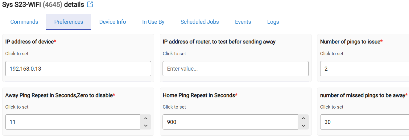

I use a combination of WIFI and my hubitat location either ive made or pieced together from other peoples work.
There is the wifi driver which pings your local network looking for the IP address of your phone (you need to reserve/ fix the ip on your router.

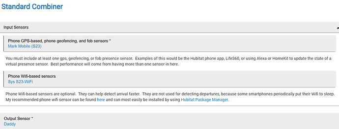

The App which you add your existing hubitat gps presence sensor and the wif presence sensor and it combines them and send them on to a virtual presence sensor.

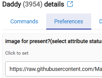

The combined presence sensor driver i use instead of a hubitat virtual to so that it has my picture on the dashboards.
Just had a look at my logs and the geofence via hubitat app seems to fire before my wifi.

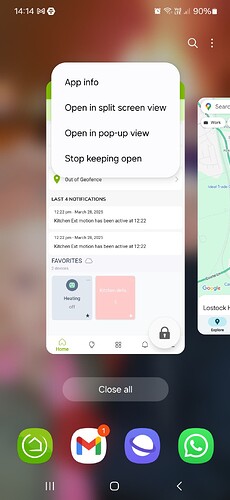

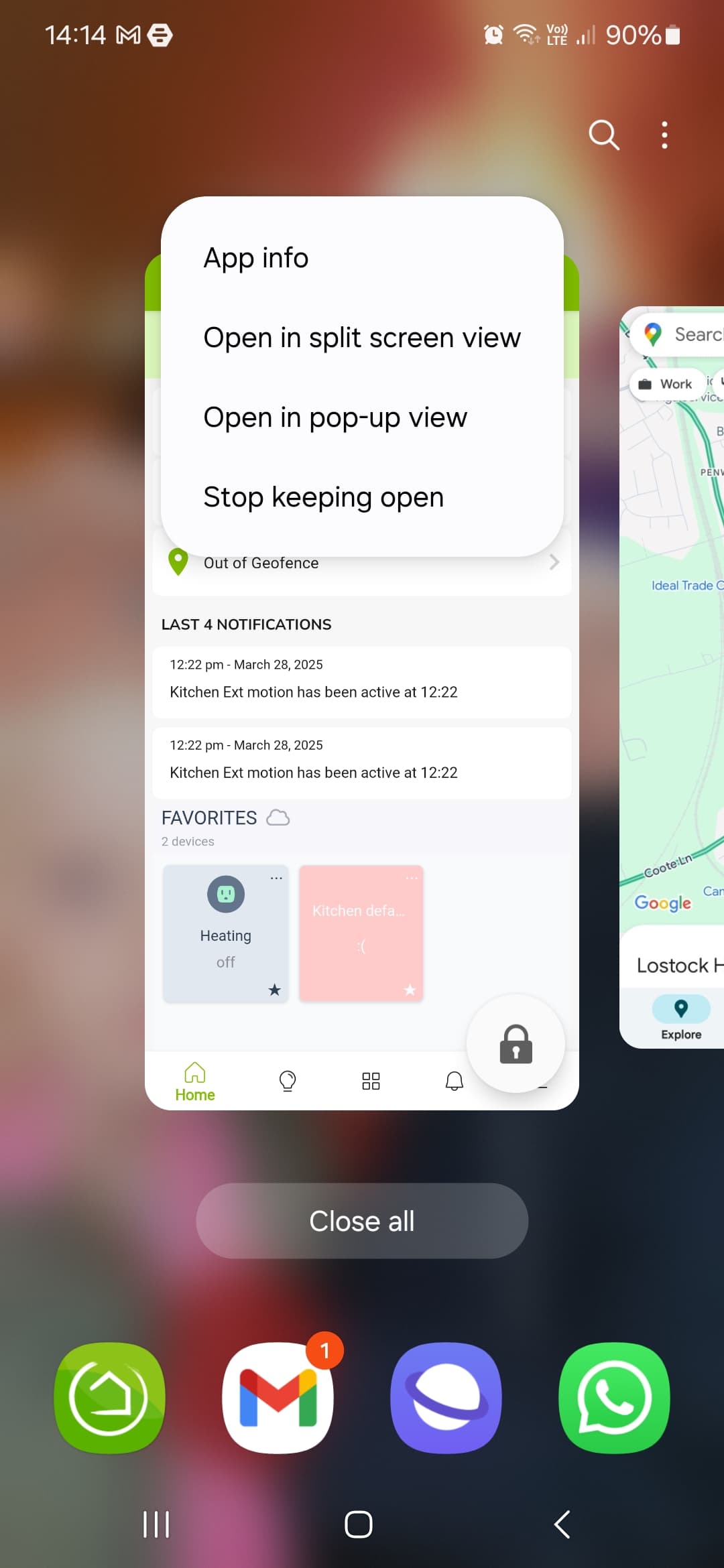

On android i have the app locked.
If you click on the 3 vertical lines to see all your open apps, then click on the hubitat icon you get options to lock it/keep open.
Im also on the android beta
