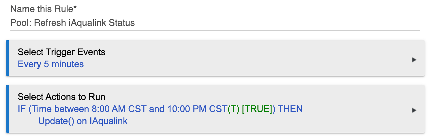

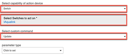

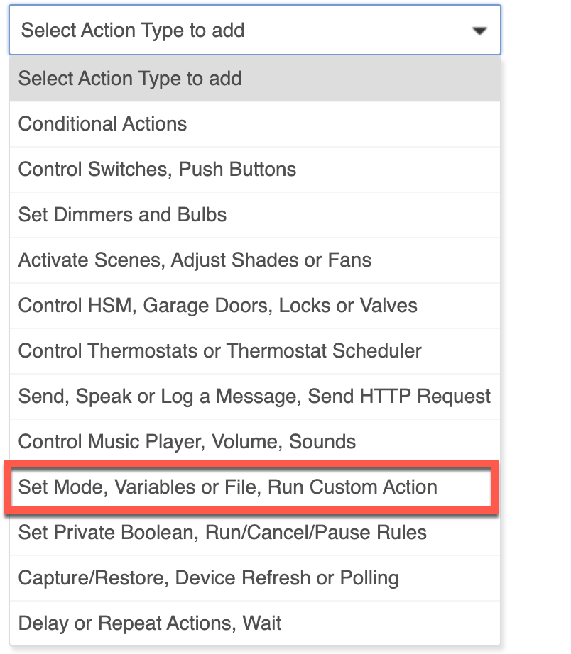

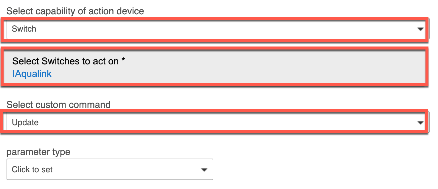

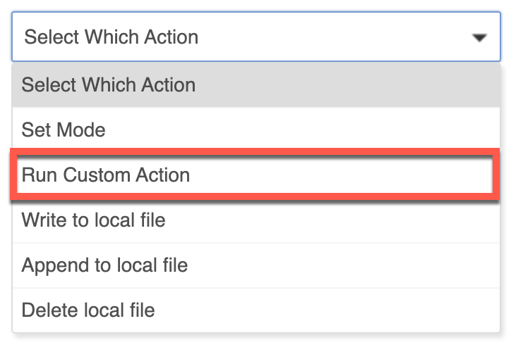

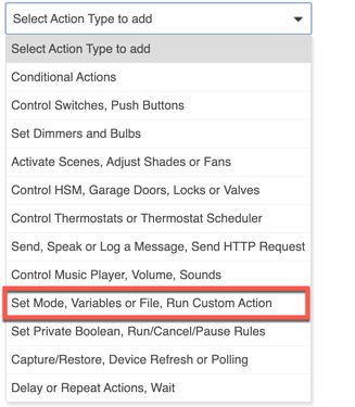

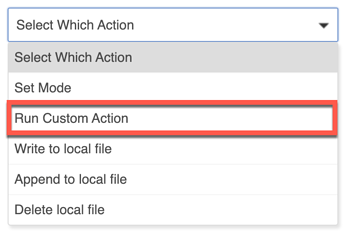

@jacobson262 - I had the same issue when installed it 6 months ago or so. I looked at the code and the update routines are in the right place yet status does not update. I was too lazy to debug at the time so ended up creating a rule in rule-machine - to do basically:
  • Every 5 minutes between 8AM - 10PM (the hours I am running the pool)
  • Do update() on IAqualink - you get to this method through the run custom action method in RM
Took a total of 3 minutes to do and works like a charm for ~6 months now - hope this helps...
Do you mind elaborating on your rule? I'm trying to find the custom attribute you are referring to... :slight_smile:
Sure. See below. Thanks, Avi
Rule Summary:
Update iAqualink custom action sequence:
Awesome, thanks! I was missing the switch part and looking for something else in capability... Got it now... I'll try it out and see how it works. I have outside lighting and other devices connected to the iAquaLink system so I'm going to run it 24/7... My complaint with the lack up updating is more to do with the lighting not showing the correct status. I bet this will fix that... Thanks again!
