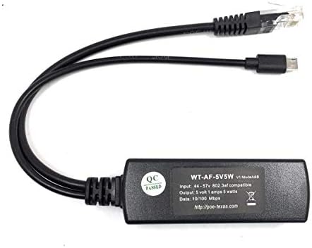

I have a long ethernet cable that I use to roam the Hubitat when I am debugging rogue Z-Wave devices. Does anyone know if I can use a PoE splitter to power the Hubitat as I wander about?
Yes you can. I use a POE splitter to provide data and power to my hub.
using that exact device on my C7 hub, works perfect

I use this one for a couple of my hubs:
I like this one:
Why do I like it? USB-C future compatibility is certainly a plus, but I like the Micro USB adapter to protect the HE's port. If I need to unplug for any reason, I can break the USB-C connection, leaving the Micro adapter plugged into the HE hub, hopefully not messing with the Micro USB connection.

Can I use my existing multi-port POE switch, i.e. can the hubitat C7 grab the power directly from the ethernet cable? (with nothing plugged into the USB power port)
No, you need an adapter like those above that splits the PoE power out to micro usb.
You do need a PoE switch, but as @dennypage said, you’ll also need a splitter like one of the devices linked to above. That’s because the Hubitat hub doesn’t support PoE itself.
If you plug in an 802.3af-compliant switch directly to your hub, nothing will happen (i.e. it won’t power up). But if you plug in a passive PoE device, you’ll probably fry the hub.
