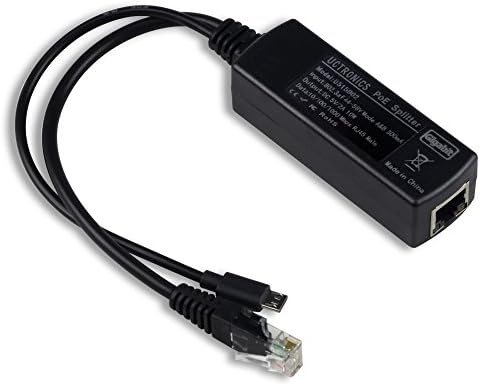

As posted earlier in this thread, here is the POE splitter that I use with my Unifi switches.
I have not had any issues powering Hubitat Hubs, Lutron SmartBridge Pro, or Raspberry Pi devices using this combination. I have everything plugged into a Cyberpower 1350 UPS.
