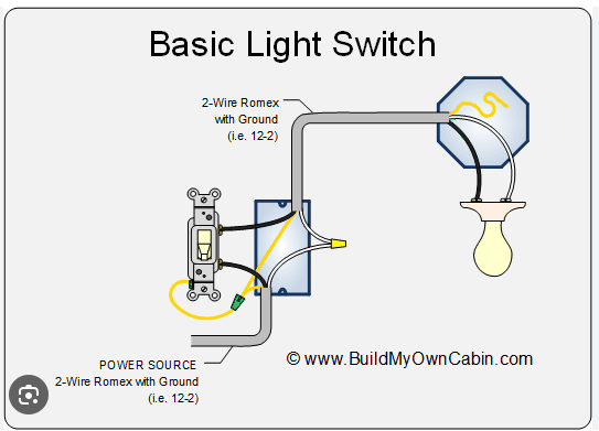

EDIT: There’s only two wires, both black, coming out of the ceiling into the current fan hosing /canopy. It’s an old house with old electrical. There’s certainly not separate wiring for fan and light here yet.
