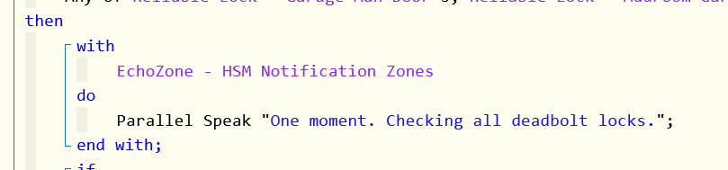

I don't think that you can get an Echo to play an mp3 file. But someone here may have investigated that further. But you certainly can have it speak text. And you change choose from many different voice profiles. Here is one of my webcore examples...

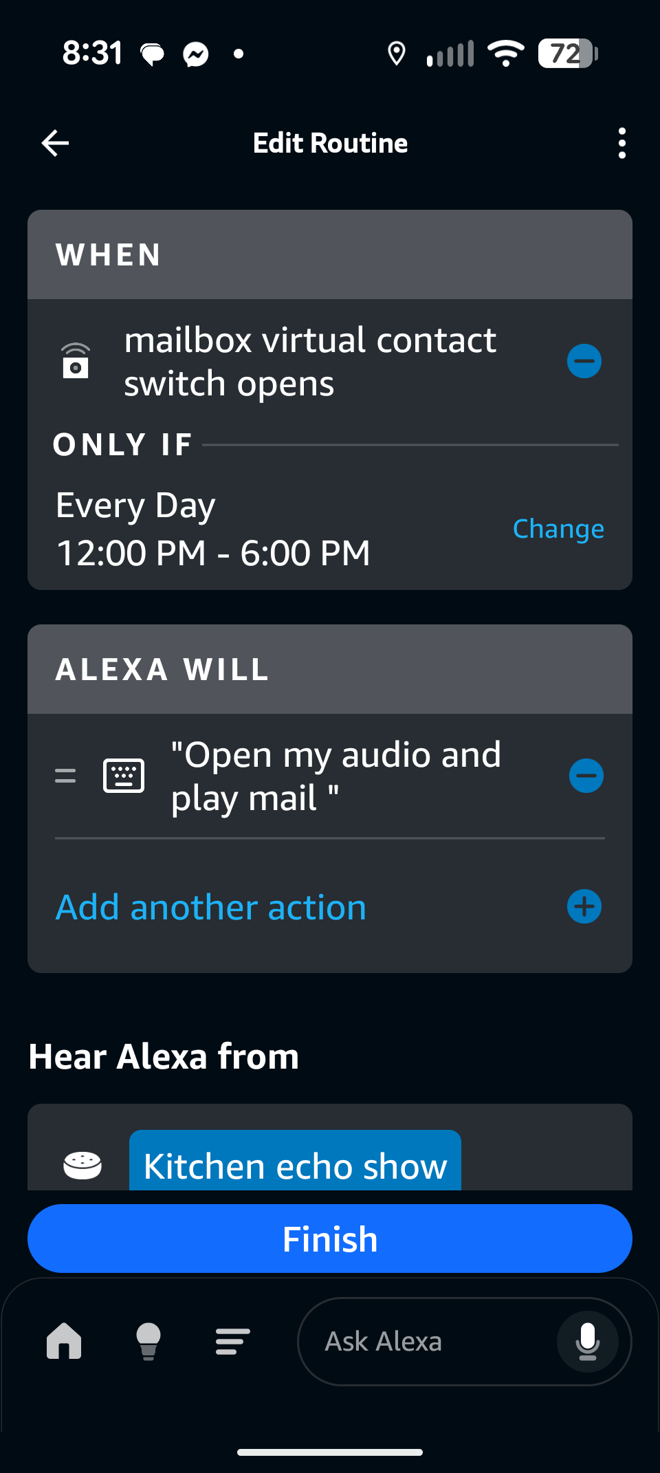

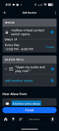

There is an Alexa skill, "My Audio." You can create a routine to play an uploaded play list or a single mp3 file. I use it to play the old AOL "You've got mail." when my mailbox is opened.

Probably overkill for you, but I use webcore for most if not all of my home tablet/echo notifications.

No sound other than the announcement. Try it, it's free. I use it for the mail because I thought it would be fun. I was able to find and upload the original "You've got Mail." My other Alexa announcements are routines for garage doors open and several other things using Alexa routines and voiced by Amazon.
