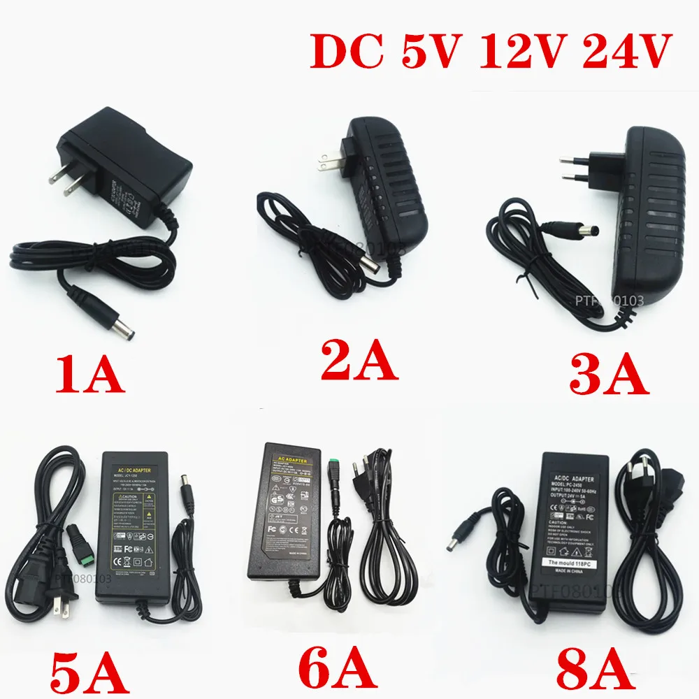

I've been looking across amazon and aliexpress at light strips, and aliexpress for example has some simple white-fixed-color-temp strips, but then the end of the cord is a red+black power wire. So, I still need to power the strip and or/control it? I guess that part is confusing. Also saw some units have some little inline dial dimmer, would cutting this part out and using a "dimmer control" unit have the same effect?
I guess at this point mostly confused beyond the light strip itself now multiple connection points, voltages, watts needed, etc. etc...
Yea. I understand. I went through the same thing when picking out the gledopto i got. Govee is nice because of how much of the complications they take out of it.
You are right though. First you find the strip you like. Then based on its power needs you need to find a controller that supports the right voltage. Then the controller has to be able to be integrated.

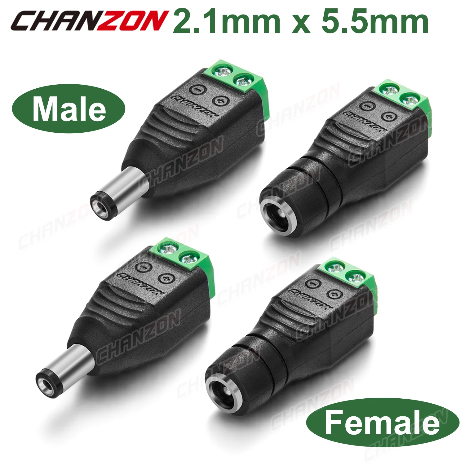

If all you saw was a red and black wire that means it was just the V+ wire and ground. As long as you had a ac adapter the right voltage you could splice it all together and use a smart outlet. If you have more then 2 wires. Then you would need to get the right controller for thr strip tech and pixel arrangement.

Well, I don't know Aliexpress so I'm a bit confused about the multi selections... But, it's quite easy to buy strip lighting that comes with the power adapter that already has a 2.1mm barrel plug on it so you don't need them. Something like this; Amazon.com
