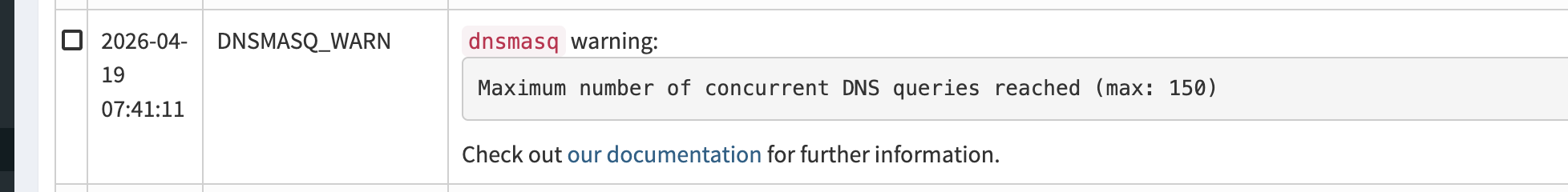

Hello, I recently installed pi-hole. It is a great tool to not only block unwanted content, but gives some great insight into your network that goes otherwise unnoticed. For Hubitat I am seeing the error "Maximum number of concurrent DNS queries reached". Could anyone help me understand the message and if/what may be done to address it? Thanks so much in advance for any guidance here.

I've never seen this from my Hubitat, but I was getting the same alert from my Raspberry Pi (I suspect it was from my NodeRED instance). It was making over 9,000 requests at midnight each day. I solved it by changing the DNS rate limit count in the PiHole settings to 10000 with no adverse effects.
The alerts/warnings/logs are showing up on my pi hole. I will take a look at the DNS rate limit count. Thanks!

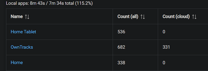

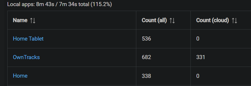

Have a look at the Logs | Apps and see the cloud calls column.
That might give a clue? You can see my Owntracks is chatty but never causes a lookup error.
I allow all Google calls to resolve.
Try this:
The warning "Maximum number of concurrent DNS queries reached (max: 150)" indicates that your Pi-hole is receiving more DNS queries than it can handle at once. To resolve this, you can increase the limit by adding dns-forward-max=300 in a custom configuration file located at /etc/dnsmasq.d/02-custom-settings.conf
Create/edit the /etc/dnsmasq.d/02-custom-settings.conf, save it and restart Pi-hole.
If you continue to receive the message after making that change, you've got something going on with your Hubitat hub that needs to be addressed. I can't provide any additrional info on that since I don't know what you've got configured/running on your hub.
Thanks for that info - I will edit the .conf file and keep and eye on it.
