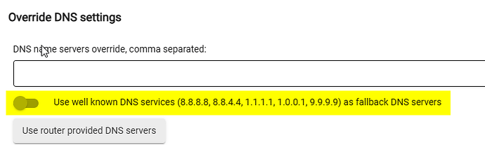

Maybe same issue as reported here.
Yes and it has been reported at least one other time as well
The fix that worked for both of us was to turn this setting off.
We both have Asus routers and Adguard Home.

I did already have the well known DNS servers off...it turns out that there was a "null" app that somehow was placed into my applications that didn't show. Doing a custom repo and typing "test" in there cleared it up, and now everything is working as expect...in fact hubitat doesn't even show on the list, whereas before it was 65% of all DNS traffic even at high traffic times.
