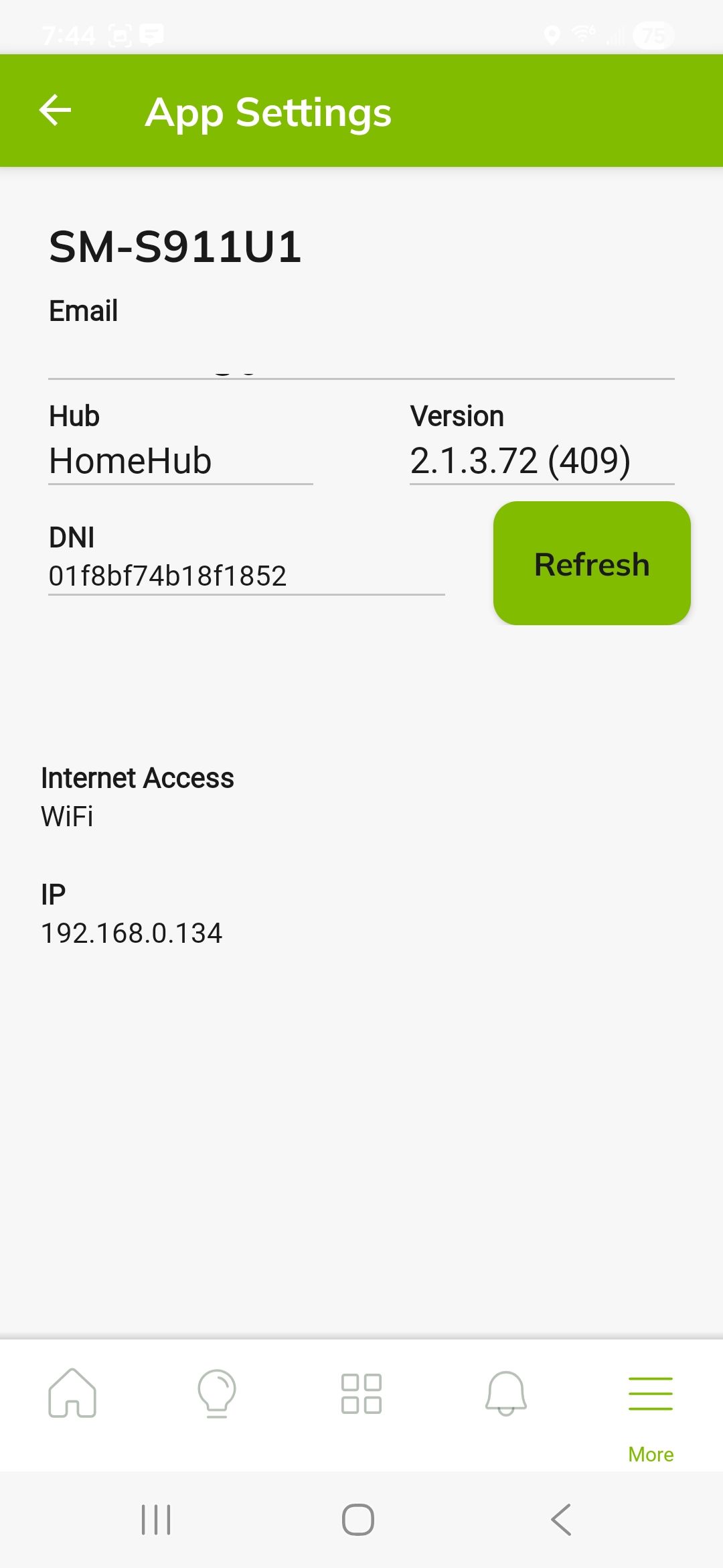

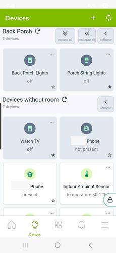

Over the past week I've noticed that presence detection using the HE app on my phone has become inconsistent.
It's been rock solid for me for quite some time.

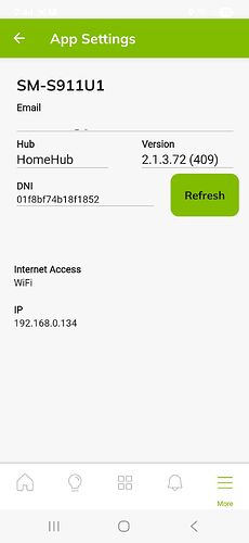

Has the app been updated recently to anyones knowledge?
The app is running V 2.1.3.42(372).

Randomly the presence detection will go Not Present and then Present again after a few minutes.

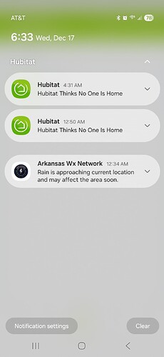

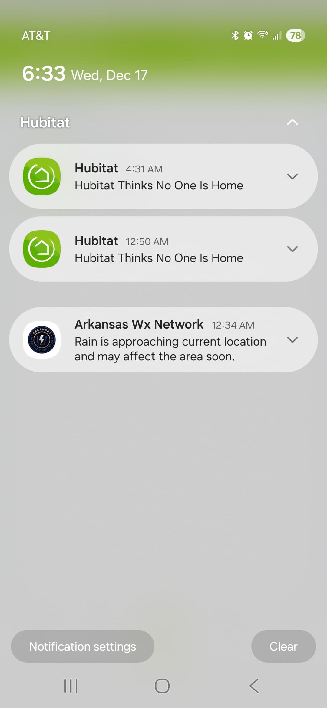

I found this post while looking for issues related to what we have going on. I have an automation based on our arriving home. I have been randomly hearing the "dad is arriving" announced. No changes other than regular updates. Had been previously rock solid.

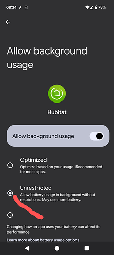

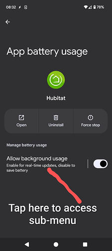

Since your "presence" updates immediately when you open the app, I suspect that your battery permissions need to be changed.
battery1
battery2

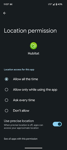

And as long as you are checking permissions, check the location permissions as well
location

I checked the settings and everything is correct.

This is still happening for me. Everything is still updated. Very odd. I'm sitting here watching a video and I can literally hear the announcement ofy arrival repeat several times in 15 minutes.

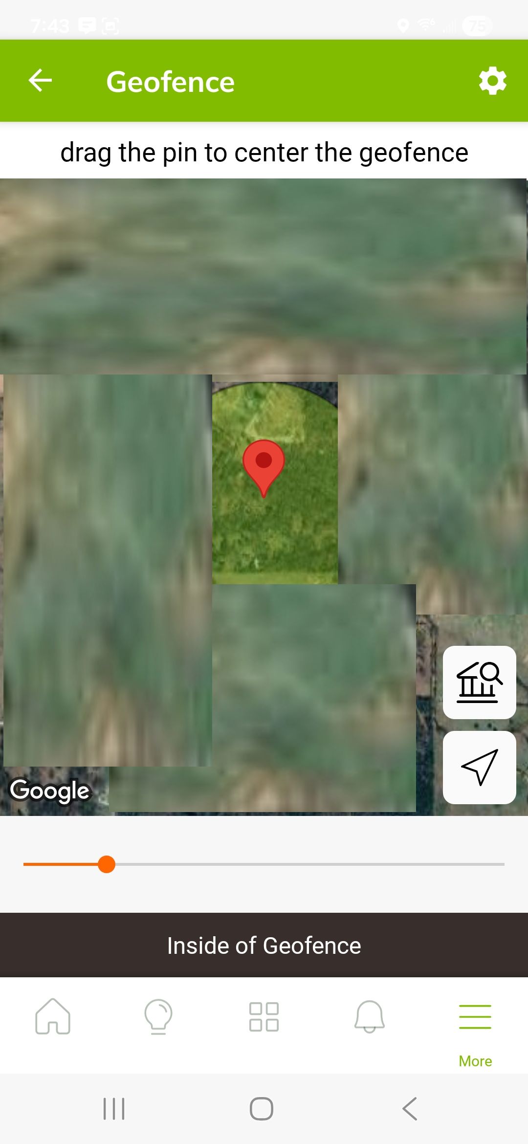

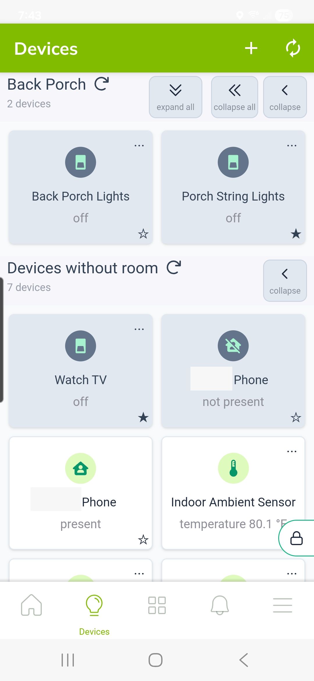

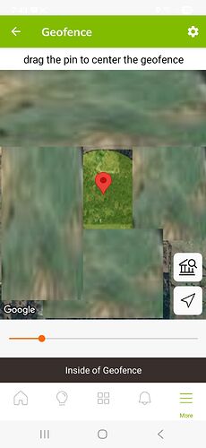

I have been recently experiencing the same issues. Checking permissions I had the location correct, but battery set to optimize. I have changed this to unrestricted and will report back. All of the screen shots were taken immediately one after the other. The devices screen says I'm not present, when the geofence screen says I am inside the geofence.

Can confirm that even after adjusting the battery setting the app will say I'm not present when the geofence tab says I am.
I've been having the same issues. It worked for me for years but recently became unreliable. When I look, I show in the geo fence, but it still shows that I have not arrived.
I started to expirience strange issues with presence. Hubitat will indicate me departed, but app say inside geofence.

How tight is your geofence setting in relation to your home.
When a GPS receiver has access to a large number of satellites in many different directions, it can pinpoint your location to within a few meters of your actual location. However when the number of available satellites is reduced to 3-4, and they may all be in the same direction (like what might happen if you are indoors) then the accuracy could be as poor as 50 meters.
If your geofence radius is set very small, like just around your own yard, then I wouldn't be surprised to see notifications that you are going in and out of the geofence.
You can test this theory by simply increasing the geofence radius to about 300 meters (1000 feet) and see if that resolves your problem.
My geo fence is (and has always) been set to a several block radius so its currently about 1700 feet or 518 m, so I find that unlikely unfortunately.
