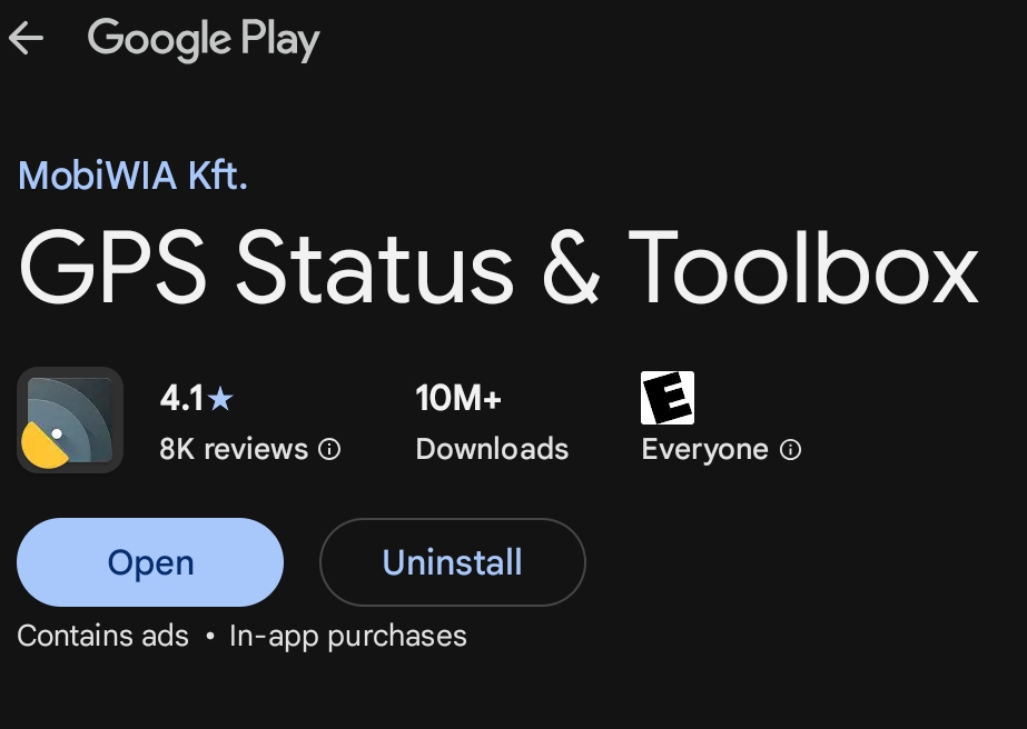

On Android, there is an app, GPS Status & Toolbox. It has a compass calibration feature where you can see the status (Green/Yellow/Red). If you open that function, and it is red, you do the rotate on each axis until you get it back to green. You can also see for yourself in realtime if you put it over or near a magnet how quickly it decalibrates.
Screenshot of GPS Status and Toolbox in play store
