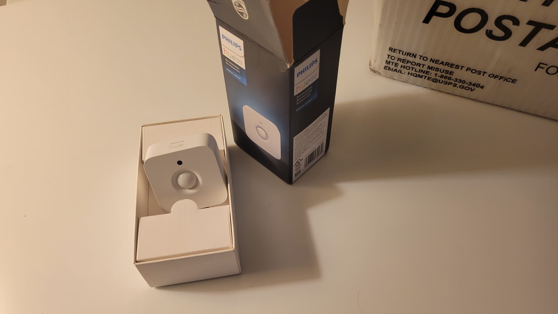

If you have the box for this still, can you post a picture of it?
This appears to be an issue with certain Zigbee 3.0 devices, and we are working on a resolution.
Here you go
Hmmm, I have one of these in production on a C8-Pro, I'm pretty certain it was added and not migrated.
I'll get another unit for testing and see if It's exhibiting the same issues as your unit.
