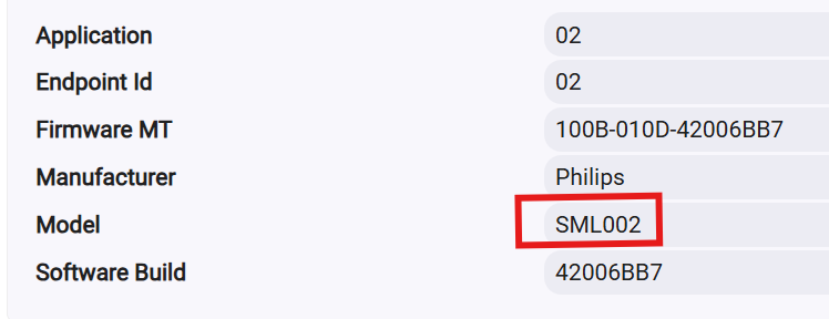

These are the device details hubitat gathered:
Firmware MT: 100B-011B-02003506
Manufacturer: Signify Netherlands B.V.
Model: SML004
Software Build: 02003506
Officially they’re supported and compatible..

Here is an example of issues and it appeared to be specific to the newer SML004 version:
I have a Philips Hue Outdoor motion sensor on my front porch (no awning, no overhang at all.) My house faces NNW, so not much direct sunlight, especially this time of year. It has worked amazingly well for year connected directly to my C8-Pro hub. No false activations. It only triggers when an animal, person, or vehicle is in range. Truth be told, I am still surprised at how well it works and how long the pair of AA batteries last. In over 4 years, I have only replaced the batteries once.
It does appear than my sensor is one of the older generation (SML002), so maybe that is the difference?
