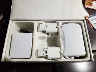

ok, I dug out the original manual and it is a little different to what @mike linked to.
I'm scanning it now and will post it.
Thanks. I step away for a bit, and action happens.
Scanned manual here
sorry about the poor quality

Well guys it doesn't look like you can get readings from each legs from what I am reading. I'll have to reach out to the manufacturer and make sure
Hmm...that's no good. Thanks for investigating.
I'll email them next week and see what they say.
