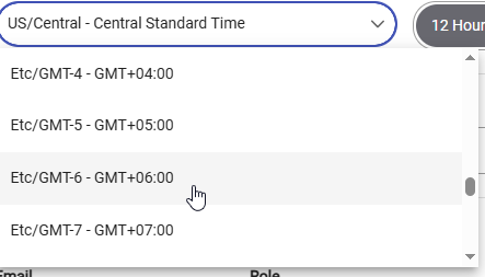

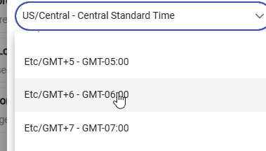

Set your time zone to the correct etc/GMT offset, I believe these stay on that same offset with no DST. That was the solution for someone in South America who had a similar problem and the old time zone kept switching with the old DST rules.
I have no idea why the GMT-# then has GMT+#:00 after it, and conversely, the GMT+# has GMT-#:00???? I have no idea which one is which. You will have to try them and find out.
One is for 12 Hr and the other for 24 Hr. :stuck_out_tongue_winking_eye:
