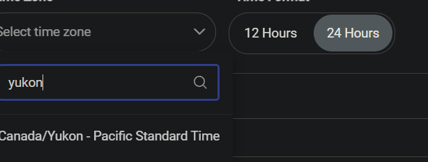

The Yukon is directly above BC and it has changed to permanent DST UTC-7.
So changing my location for time resolution won't work if I just say that's where I live?

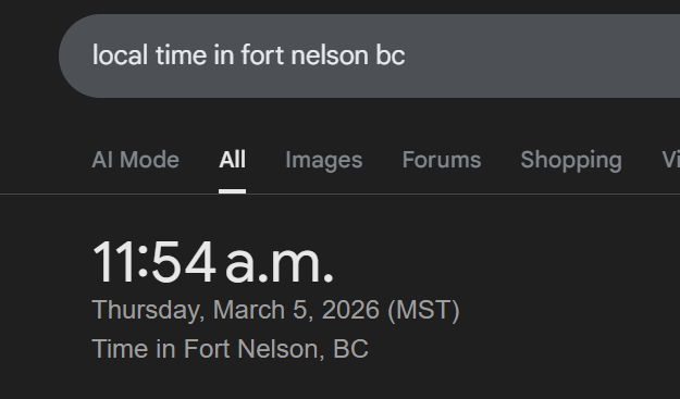

Fort Nelson changed a while back, 2015.

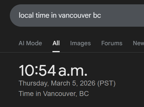

It should be a quick check on your hub. Not too sure of the relevance but... :man_shrugging:
58°48′21.3″N 122°41′47.3″W
ft nelson
vancouver
