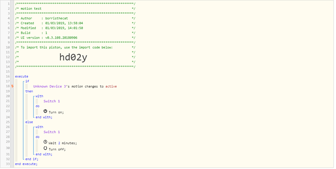

You have a trigger for the active statement and a condition for the inactive statement.
Try changing it to changes to.
IF you look in the left column you will see the lighting bolt.

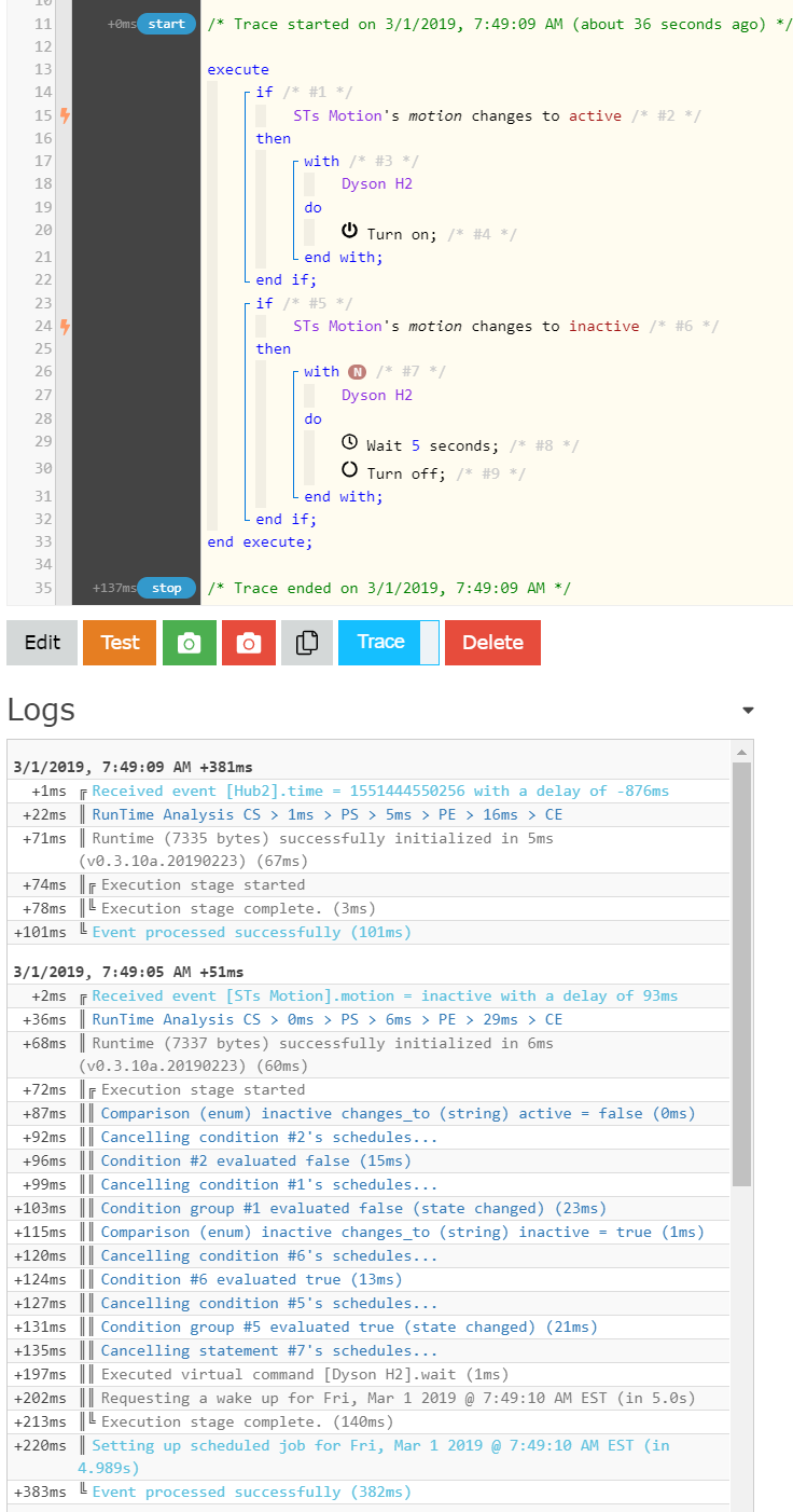

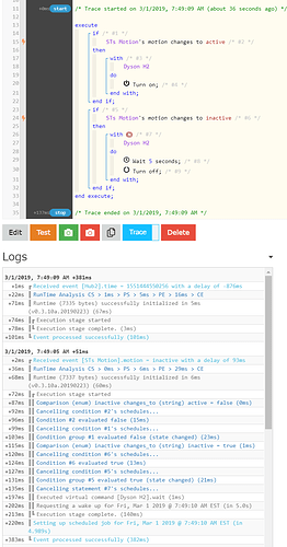

Not exactly Netflix quality but this video shows that piston in action.

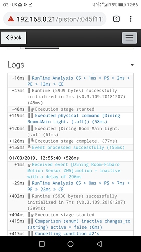

On my phone I cannot see what the logs say but I can see that the 'inactive' section goes green and the timer counts down and matures. Not sure why the light doesn't turn off.
Can you try this on a different type of light. A non-ikea one.
When you look at the logs or the events for the IKEA light do you see the turn on and turn off events?
Looking at the logs it looks like the 5 second timer starts. When it matures it starts execution but there is no statement to say an off command has been sent.

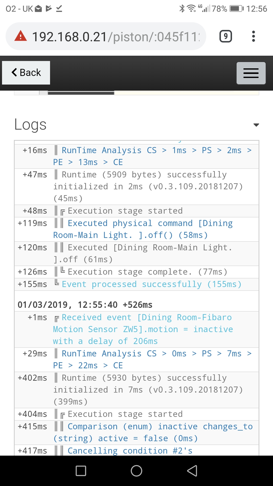

In my logs I see the command
'Executed Xxxxxxx.off' between the Execution stage started and Execution stage completed statements.
Looks like a bug then.
You can see what I mean below when you compare my logs to yours. (ON my mobile so difficult to highlight).

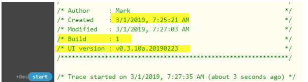

@nh.schottfam, Love the fact that this has some life again. Reading through the latest issues, I have a thought. Since you 'correctly' forked this version of webcore without intending to merge it back (Again I believe that is the correct approach), we probably need a few specific things.
  1. A new name for the app - on that shows up in the apps section in HE. HECoRE or WebCoRE4HE or something.
  2. Any maybe, just maybe a different color scheme for the piston screen shots - so we all know we are really actually and indeed using WebCoRE4HE and the user is not making a silly mistake. For example, make the text that webcore auto generates and comments out - to be red instead of green.
    2a) Or maybe something in the 'UI statement' in this screen shot. In effect change the version to v.HE.0.1
Just some ideas. I fear version management will bite you (us) in the long run if not.
