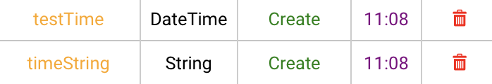

While I couldn't get a DateTime variable to be passed from Homekit to Hubitat, I did get this to work using a combination of String and DateTime variables.
  1. Create two variables. One of them is a String variable (timeString below) and exposed to MakerAPI. The second is a DateTime variable (testTime below)

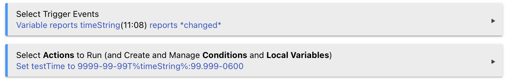

  3. Create a Rule (or other Hubitat automation) that sets the DateTime variable to the value of the String variable
(the 99.999 should be replaced with 00.000 )

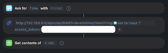

The shortcut itself looks like this:
Would be nice if someone could post a way to do this directly with a DateTime variable, instead of using a String variable as an intermediate.

This part is easy. Can you create a shortcut like the one I've shown above?

Got it:
I've not done much with Shortcuts, so it took be a bit of head scratching.
I hadn't realised that URL simply creates a URL.
The shortcut then is
Ask for Time
Format date (ask for input). Another thing that confused me is you can't have a custom format of a time, so even though I just want the time, I had to choose date, custom format and HH:MM
That result is then pasted into the following URL
http://192.168.0.XX/apps/api/20/hubvariables/AlarmTime/9999-99-99T[Formatted Time]:00.000-0600?access_token=[TOKEN]
And finally it's opened.
Just need to find out now if it's possible to open the URL without opening the browser!
Yes, make the final part of the shortcut “Get contents from URL”
