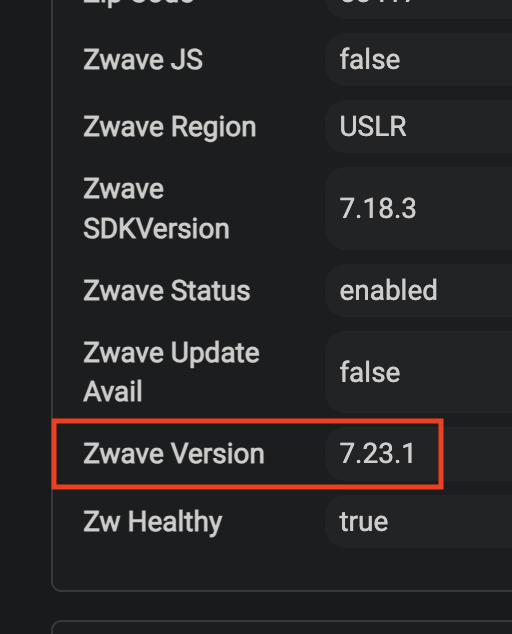

I don't know where it pulls this tidbit from within the hub, but Hub Info Driver reports Zwave Version as 7.23.1...
Interesting.. But we only report 7.23, because that's all we get back, so the .1 must be coming from the driver..

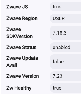

Weird...hub info doesn't give me any ".1" on the ZWave Version on C8-Pro:
...wait for it...does give .1 on C8:
Interesting difference, @bcopeland?
That is interesting!
Shortly after the update was released, I remember someone else posted a shot of theirs where it was 7.23.1 too -- that's the only reason I ever bothered to notice mine was that too.
My shot above is from an 8-Pro (my only hub)
Still not coming from us.. Must be in driver somewhere.. :man_shrugging:
