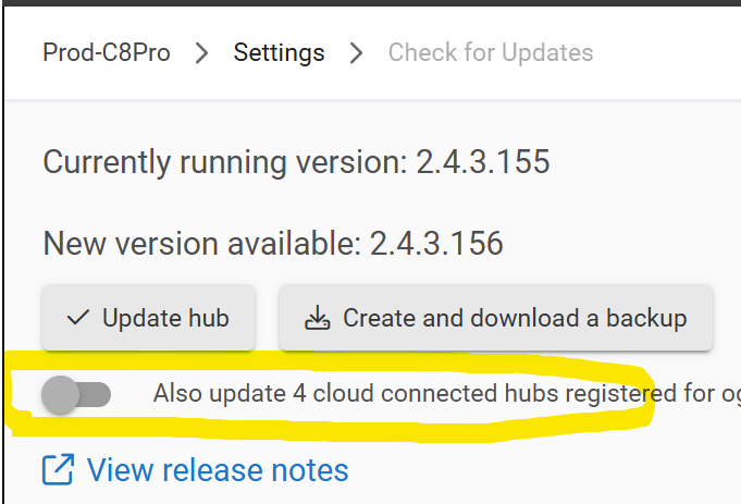

One click firmware update in 2.4.3.133?
I also have two of the five hubs on my account powered off in a drawer as well...so that is not causing this wierd issue. I see the prompt on my other three hubs that are in active use. :man_shrugging:

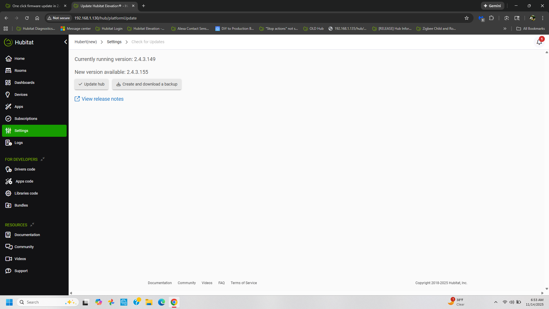

This is Chrome. Also checked Edge and the mobile app.

I first noticed this issue a few builds ago. On my C8 Pros, when I update the hub, I no longer get the option to update other connected hubs. The last time I saw that option was on a C7 a few weeks back, right before I wiped it for storage. I did recall seeing the option early on with the C8 Pros, but it hasn’t appeared in at least the last three or four updates.

Well, today I decided to test my hypothesis. I powered up all three of my 'spare' HE hubs that are registered to my Hubitat account. I upgraded the three 'spare' hubs to the latest firmware. With all 5 hubs powered up, I then went to my main C8-Pro and C8 development hubs and checked for a firmware update. Guess what! It worked!
I finally am seeing the option to upgrade multiple hubs!
This is just a single data point. It could be a coincidence. Perhaps the two always-on hubs just needed additional time for the option to finally appear. But this is for sure the first time I have been given the option. :man_shrugging:
Interesting! That does cloud things up a bit...no idea why mine would not care about offline hubs and yours would. :thinking:

I just used this again to update all 3 of my hubs at once from 2.4.3.155 to 2.4.3.156, by selecting the checkbox. But all of my hubs are online.
I still don't see them either.
Seems that the issue is user specific and widespread enough.

Used the update hubs toggle this morning. It updated the non-beta hubs to the the latest "official" release and the beta hub to the latest beta platform.

Still don’t see the checkbox. I’ve sent you a message with my hubs ID.
