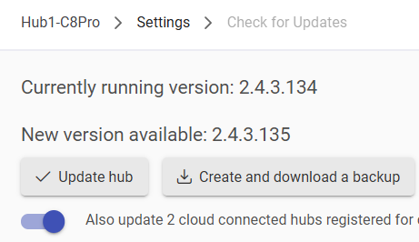

And looks like this when there is an update available. I was updating on my C8-Pro and it completed my C7 and C8 automatically:

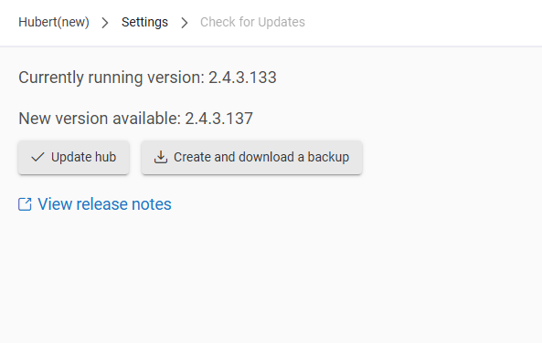

I have 2 hubs meshed on the same network with update available but do not have the switch
Screenshot 2025-10-15 123709
I didn't see that switch, either.

As I said in my first posts, I had .133 installed on both hubs and didn’t see the switch when updating to .137.
I have all the above. Just rebooted both, still no button. Don't know but it looks like I am not the only one.

As shown in my screen shot above, I was seeing it on .134 going to .135.
