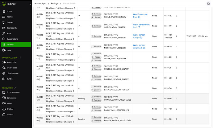

On zwave detail page I have devices with no name
What does it mean if I am seeing devices with no name on the Z wave detail page?
Incomplete pairings have created ghosts.

I have tried the refresh and then force remove but it fails on all the ghosts I am seeing.
Since this is a very recent migration would it undo some of what I have tried if I intsalled a backup from before I started trying to remove the ghosts??
Probably had those ghost devices on the old hub and moved them over. Unless you just recently attempted to pair devices to the new hub?
What good would that do? Did you somehow make things worse with your attempts? Otherwise not sure what you would be trying to accomplish. If you locked up the radio just do a shut down and unplug the hub for 30 seconds. That is outlined in those instructions I think.
No, I think you went too far in that guide, and skipped part of section 3. Stick to 1-3, the new info in section 3 covers how to switch to ZWJS to help remove the ghost nodes.
Thank you so much for your quick reply. Yes I did overlook the part about ZWJS I think partly because I had previously referenced another post that covered similar topic, but it was older. After I found that on the Z wave page and changed it over I was able to remove the ghosts with no problem.
