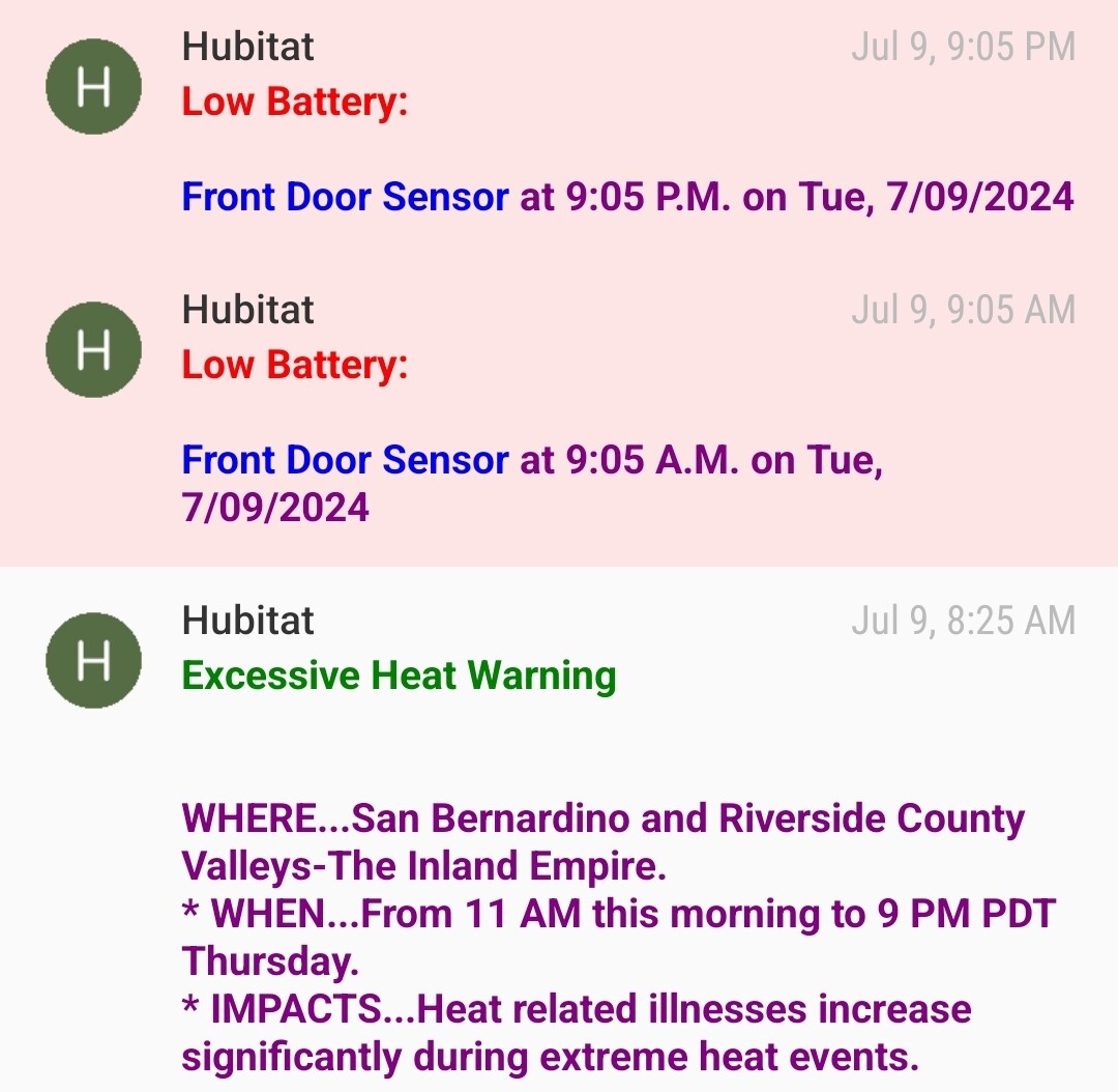

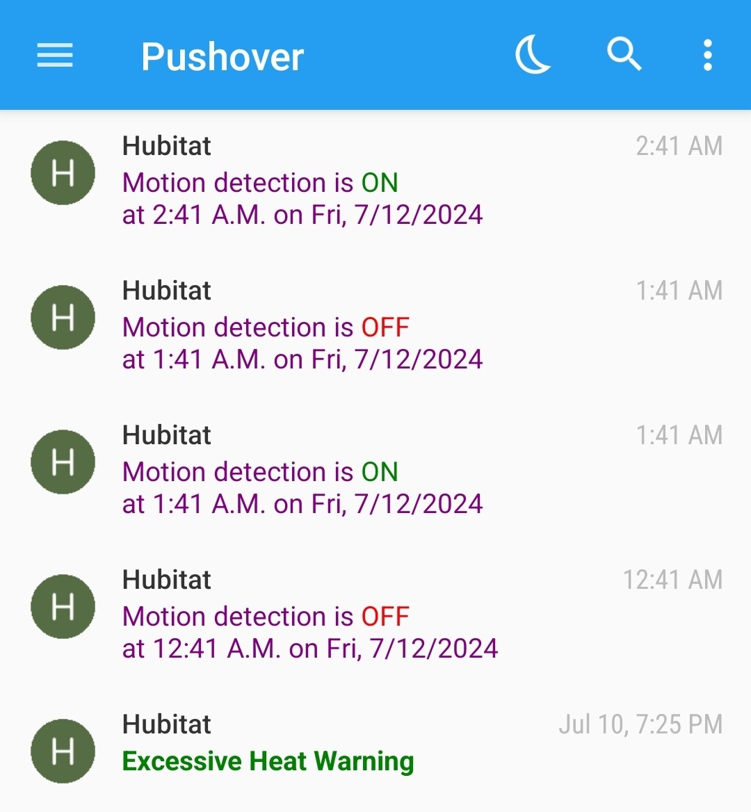

It's even nicer when you use color codes.
Wasn't even aware yet about the colors...
Oh now, this rabbit hole looks like it's very deep. :wink:

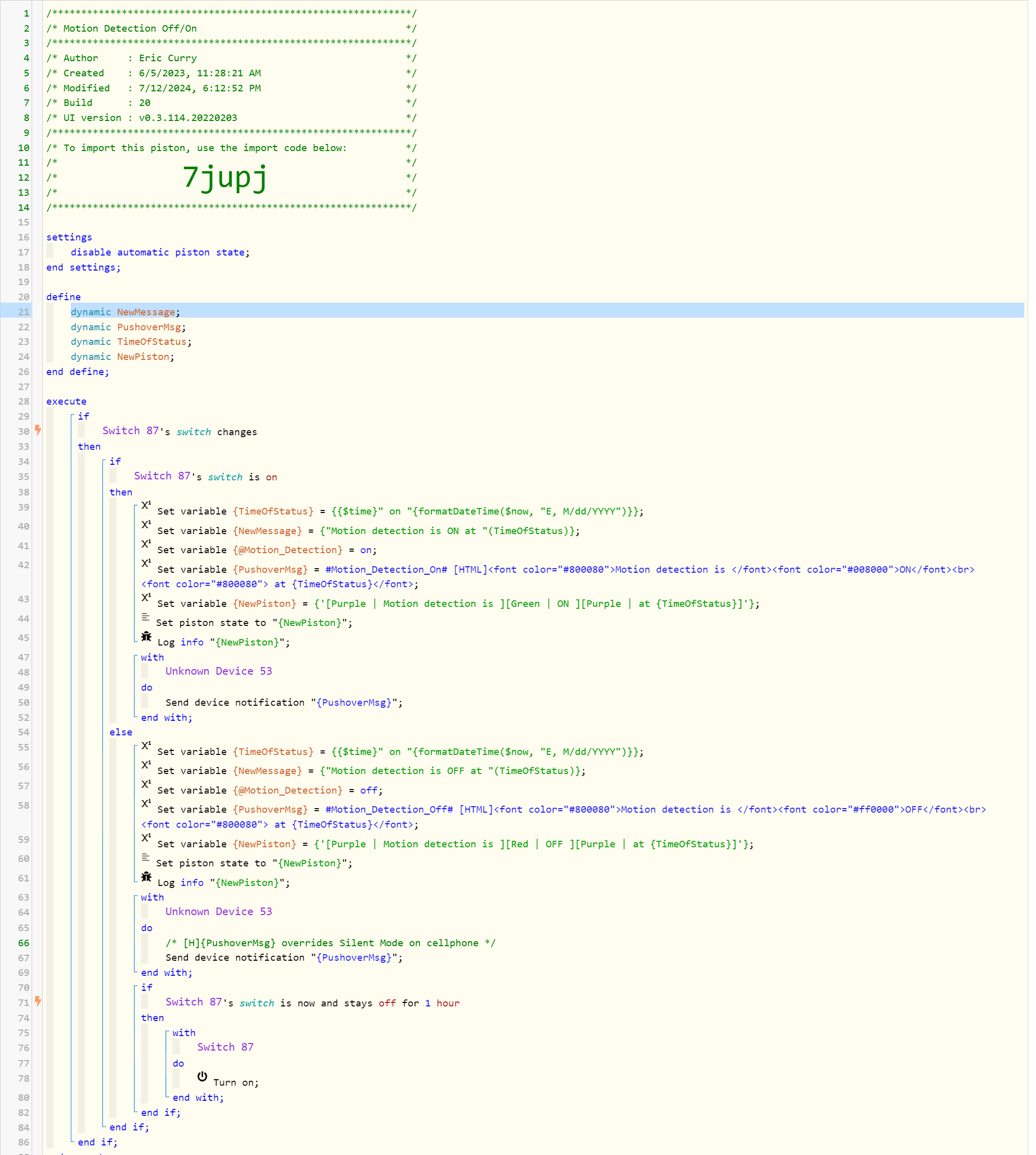

Worth noting you can include HTML in the pushover messages. I use bold in several of mine and line breaks
Yes... It took a couple of tries to find out what had to go before and after in order for all the information to work correctly.

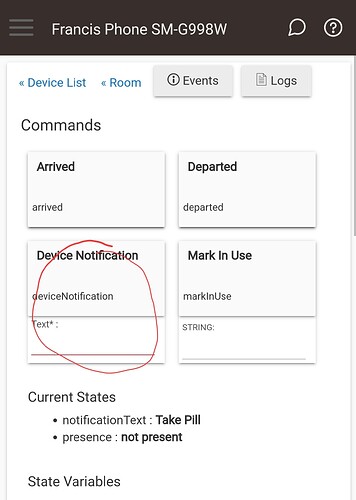

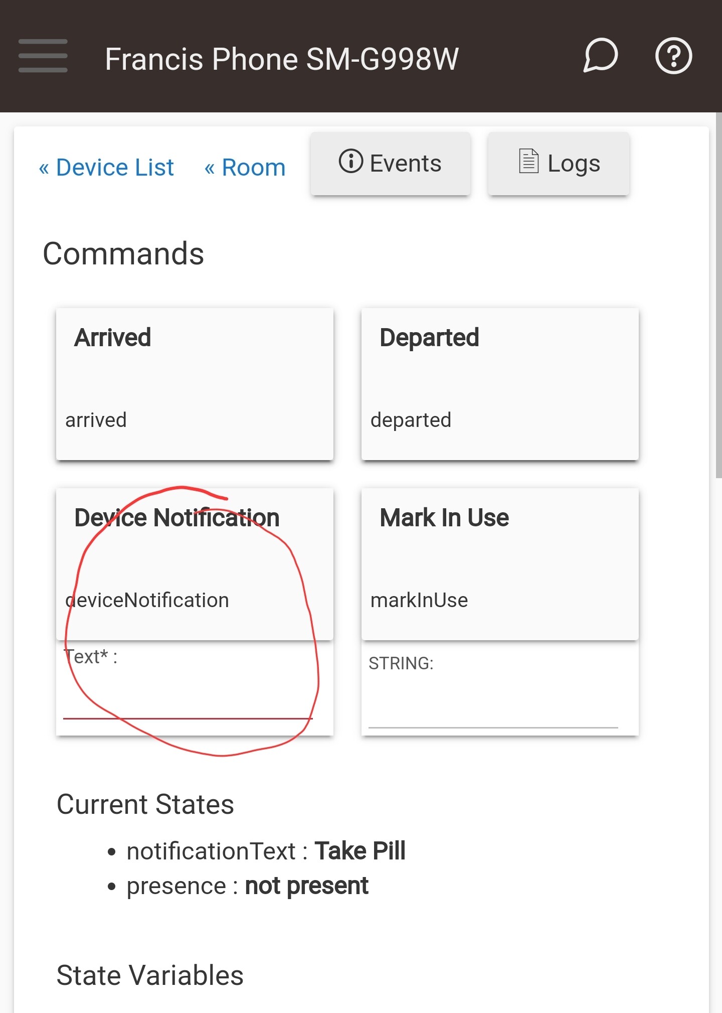

I'm kind of confused. Can't you just push a notification if your wife's phone was added to Hubitat as a presence device?

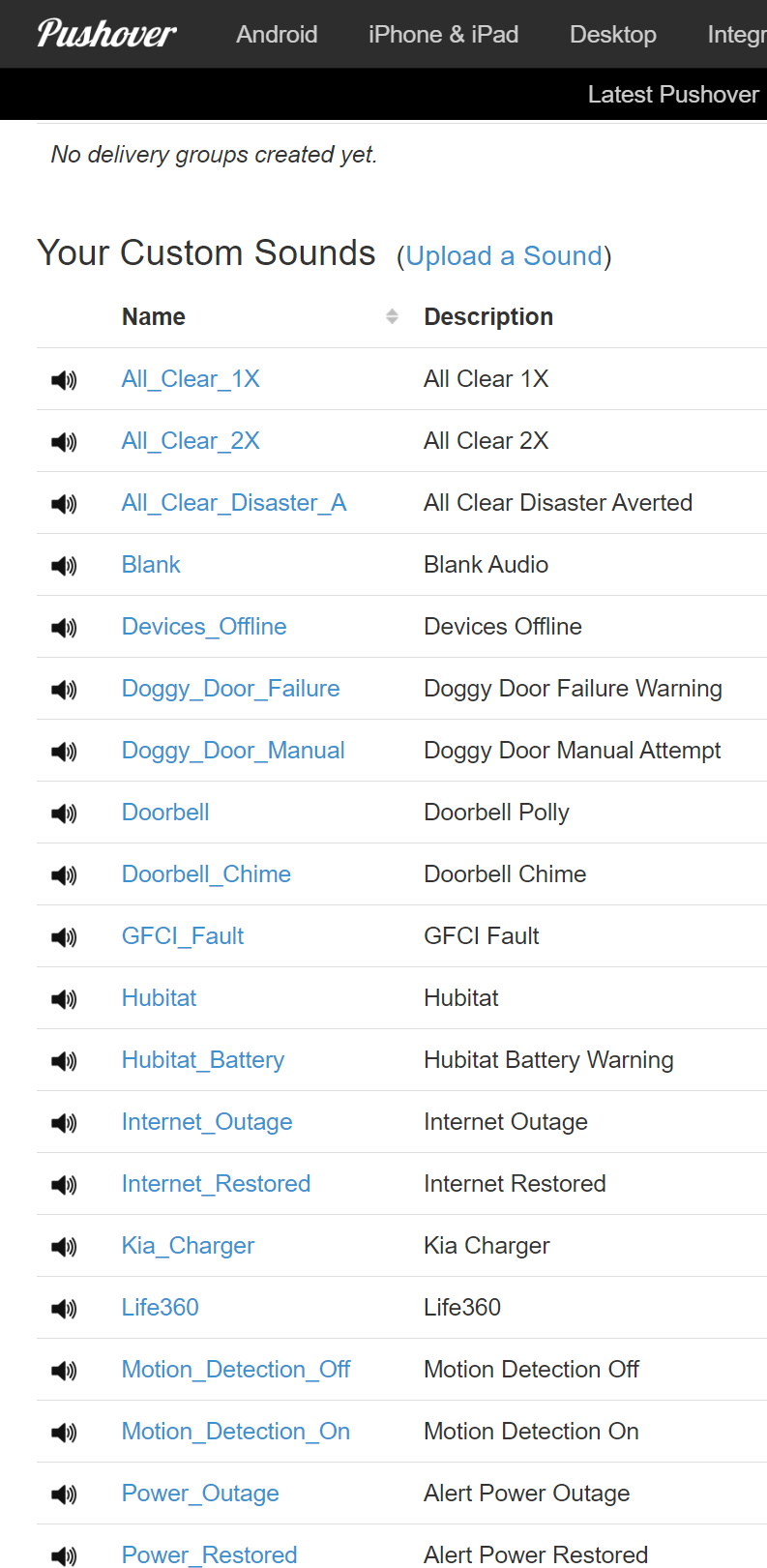

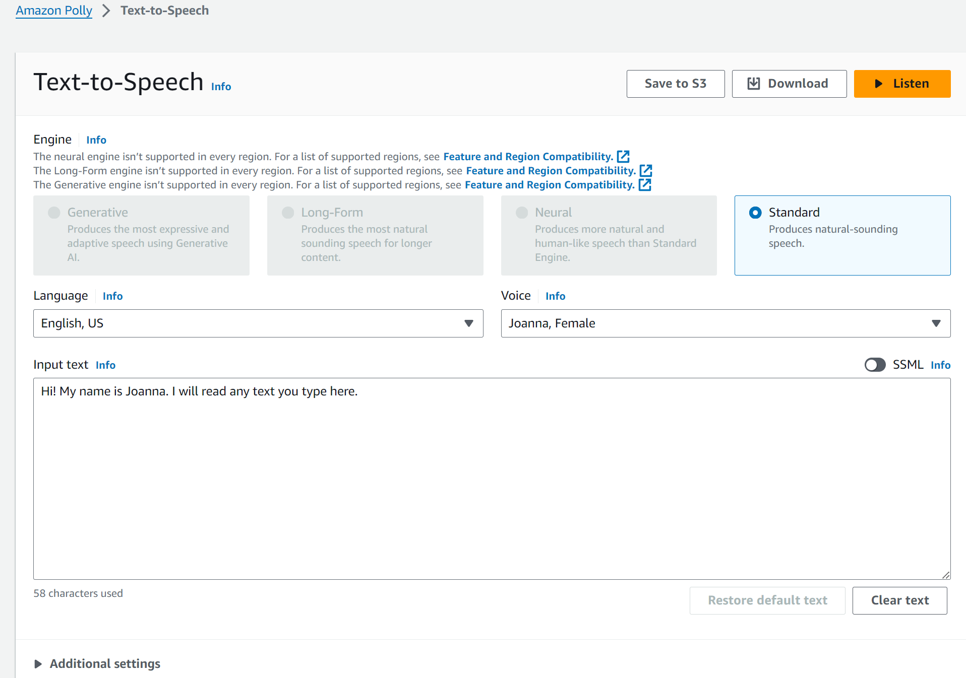

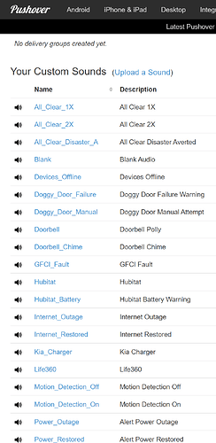

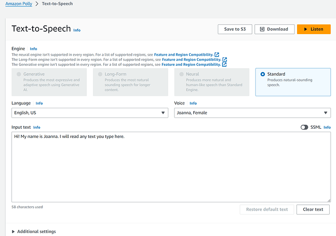

Fun Fact: I use Amazon's Polly to create Sounds and Sentences in Alexa's voice. You will need to create an account.
You can save the mp3, and then upload it to Pushover: (Spaces aren't allowed, so I use Underscore)
Bingo! Personalized and standardized notification sounds.

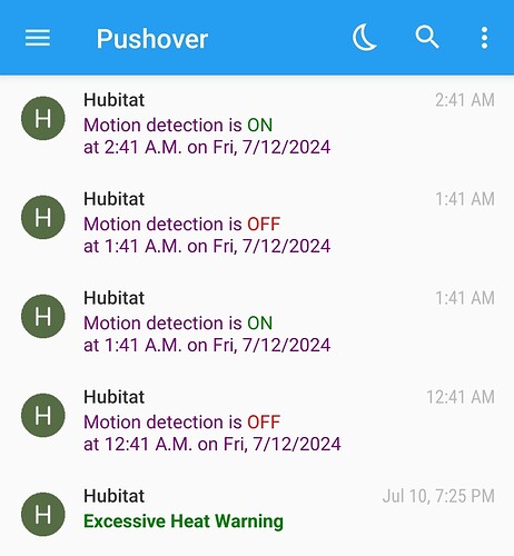

Dunno... As I said, I use Webcore for this. I can use any color I want.

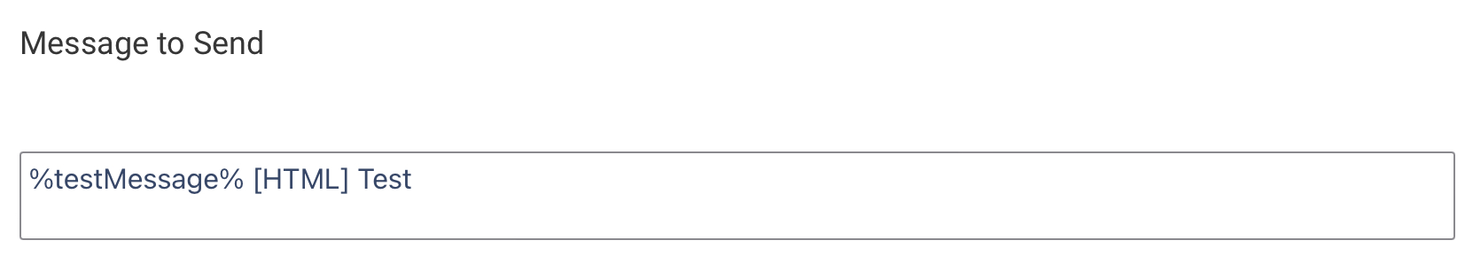

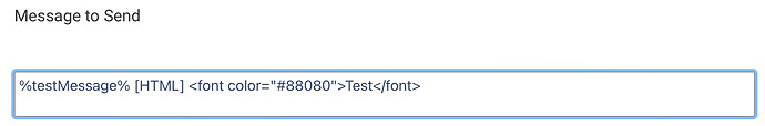

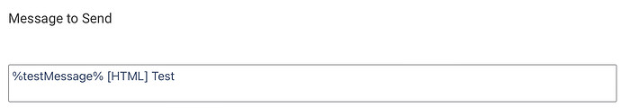

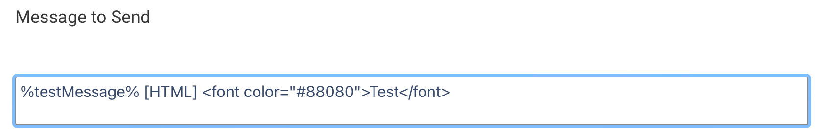

Curious if anyone has been able to add HTML codes into a message coming from RM?
I just tested this and as soon as I move focus away from my text box with this in it:
The text gets changed to:
Maybe this is intentional? And if so, I wonder if there is a workaround…? @bravenel ?
(Note: I had also tried adding the text to a variable with the same result (hence the %testMessage%))
Unfortunately a recent update removes HTML. I had to create a work around on my Gmail Notification code.
