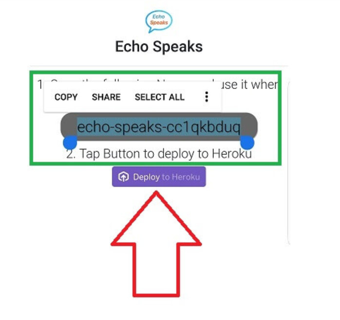

Well I know the directions show a cell phone and I am using a desktop, but here are the steps for deploy on the directions from the main topic here ([BETA] Echo Speaks V4):
Here is what I see on what appears to be a new "deploy" tab and very complicated instructions for deploying ... directions have no mention of 3 ways to deploy and choosing one:
I have re-read the directions several times and everything tracks up to this point. I guess I might have missed something. I will go back over it again but don't think I missed anything.
