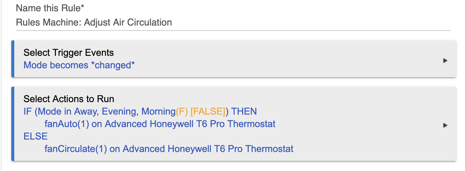

Hi there everyone, I'm seeing an issue with a Rules Machine rule that changes the fan state from Auto to Circulate. When I created the rule, Rules Machine strangely required a parameter for the Fan Circulate state and the Fan Auto state - which is weird because the driver page for the thermostat doesn't show any parameters associated with those states.

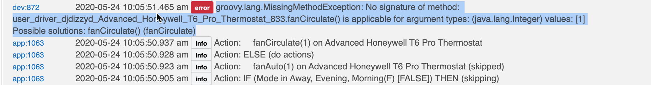

Now I get the following error message in my logs when the rule triggers...
groovy.lang.MissingMethodException: No signature of method: user_driver_djdizzyd_Advanced_Honeywell_T6_Pro_Thermostat_833.fanCirculate() is applicable for argument types: (java.lang.Integer) values: [1]
Possible solutions: fanCirculate() (fanCirculate)

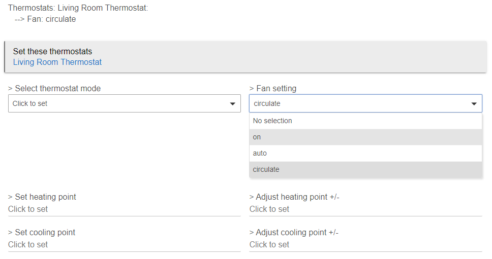

I didn't check the thermostat for a lock, but you can accomplish the same thing in Rule Machine (maybe Simple Automation Rules, too).
Pseudocode:
Trigger: Temp setpoint on T6 thermostat *changed*
Action: Set T6 thermostat to scheduled setpoints.
Then you just set your schedule in the HE thermostat scheduler. That would make it impossible to change the temperature without changing the schedule on the HE.
