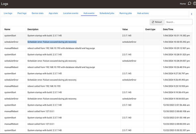

In the hub events, I do see a Scheduler failure -- could this be it?

Looking at the Hub Events it appears the scheduler errors starting appearing out of the blue on the 4th of January at 9:18pm while running 2.3.7.140.
Can you check the regular Past Logs page around this time to see if any logs are recorded to indicate what may have happened?
