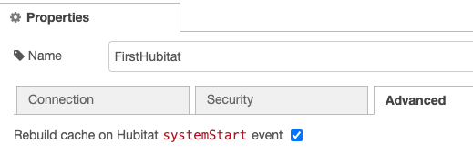

if you reboot HE then make sure in the HE Nodes config under advanced you have "Rebuild cache on Hubitat systemStart event" checked.

I don't think there's a question at all... because it's intended to work this way OR work with a cache refresh... your choice, although it's global to the hub.
I have the option enabled for each of my hubs.

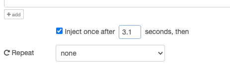

Additionally, I have many Inject nodes:
where a Msg is sent some time after a NR restart or Deploy.

I have the rebuild cache checked. No issue when my hub restarts.
I do use some inject nodes exactly as you to initialize some logic gates. I was just trying to avoid having "wires" all over the place.

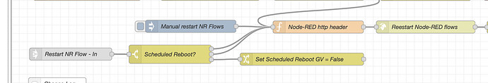

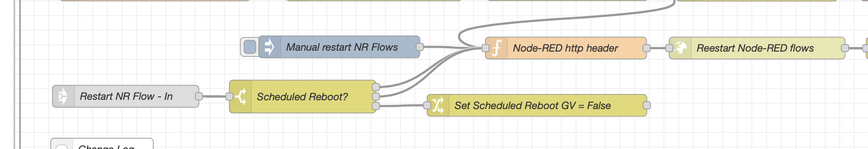

I have a NR flow that subscribes to a HE hub restart event and restarts a NR flow that has the event node on it. I did this primarily to fix an issue with capturing HE logs via a a websocket node. What would happen is that while the node would show connected, it was not getting any data. Maybe something like that would work for you?

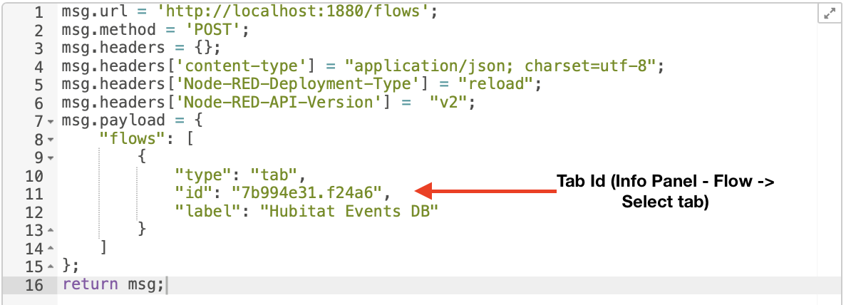

[{"id":"c00b82c.f11e5","type":"link in","z":"f8301745.84255","g":"ed35d08.60c2eb","name":"Restart NR Flow - In","links":["900f7db3.900b9"],"x":284.9524230957031,"y":2290.5239181518555,"wires":[["e7d89981.94d008"]],"l":true},{"id":"45ea655a.87abf4","type":"inject","z":"f8301745.84255","g":"ed35d08.60c2eb","name":"Manual restart NR Flows","props":[{"p":"payload"},{"p":"topic","vt":"str"}],"repeat":"","crontab":"","once":false,"onceDelay":0.1,"topic":"","payload":"","payloadType":"date","x":576.6192016601562,"y":2222.85733795166,"wires":[["bd7872ea.ff2788"]]},{"id":"e7d89981.94d008","type":"switch","z":"f8301745.84255","g":"ed35d08.60c2eb","name":"Scheduled Reboot?","property":"scheduledReboot","propertyType":"global","rules":[{"t":"false"},{"t":"null"},{"t":"true"}],"checkall":"true","repair":false,"outputs":3,"x":526.619140625,"y":2290.857177734375,"wires":[["bd7872ea.ff2788"],["bd7872ea.ff2788"],["cca233d5.227588"]]},{"id":"bd7872ea.ff2788","type":"function","z":"f8301745.84255","g":"ed35d08.60c2eb","name":"Node-RED http header","func":"msg.url = 'http://localhost:1880/flows';\nmsg.method = 'POST';\nmsg.headers = {};\nmsg.headers['content-type'] = \"application/json; charset=utf-8\";\nmsg.headers['Node-RED-Deployment-Type'] = \"reload\";\nmsg.headers['Node-RED-API-Version'] = \"v2\";\nmsg.payload = {\n \"flows\": [\n {\n \"type\": \"tab\",\n \"id\": \"7b994e31.f24a6\",\n \"label\": \"Hubitat Events DB\"\n }\n ]\n};\nreturn msg;","outputs":1,"noerr":0,"initialize":"","finalize":"","libs":[],"x":886.2862396240234,"y":2224.52481842041,"wires":[["766ea13b.52fee8"]]},{"id":"766ea13b.52fee8","type":"http request","z":"f8301745.84255","g":"ed35d08.60c2eb","name":"Reestart Node-RED flows","method":"use","ret":"txt","paytoqs":"ignore","url":"","tls":"","persist":false,"proxy":"","authType":"","x":1147.2866668701172,"y":2224.525062561035,"wires":[["5cd01c6e.ed7d7c"]]},{"id":"5cd01c6e.ed7d7c","type":"change","z":"f8301745.84255","g":"ed35d08.60c2eb","name":"Delete Payload","rules":[{"t":"delete","p":"payload","pt":"msg"}],"action":"","property":"","from":"","to":"","reg":false,"x":1376.2864227294922,"y":2224.858070373535,"wires":[[]]}]
The function node creates the header that calls a NR API to restart that flow.
Hope this helps.

Did you get the function to actually restart a single or all flows?
I tried that exact function and it restarted all the flows. I was not able to restart the declared node. And I did use the correct label and id.
And reading further through relevant threads on the NR forum it appears the reload on line 5 of the function causes all flows to restart. It ignores the "flows" payload. It appears as the author of that function was trying to adapt the admin api that allows individual flows to be changed through api calls.
