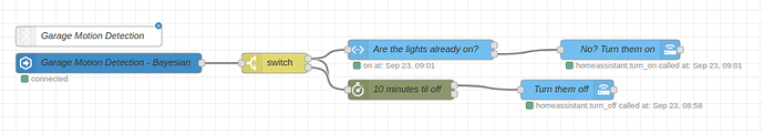

Here is the version that doesn't use a device block for the light status at all.

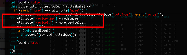

For devices, the msg object only has the "payload" set with the attribute information. However, you have no idea what device it is for. What I would suggest is to have at least the "name" and/or "deviceid" set too. The node has all of the necessary information.
@fblackburn, might I request a change to the device node to include the name and the deviceid in the "sendEvent"? You would have to add the following two lines in the device.js callback
That would be handy. I rarely like to use DeviceID, so am not interested in that, but I could remove a number of parallel path functions nodes I've had to use if the "name" were in there.
For instance, on this I could pump both events into a single switch and single function node if I knew where the event came from... Reducing from 2 switches to 1 and 3 function nodes to 1.

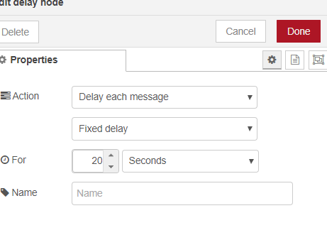

It all depends on how you did the delay. If using a delay node, you would send a message with msg.reset in it to the delay node. If in a function node in code, you would cancel the setTimeout.
I'm using the delay node. I'm not sure how to send a message to the delay node?
Well, based on whatever condition you want to cancel the delay, put a change block in the path that sets msg.reset to anything, and pipe that into the delay block.
So you would probably end up with two paths into the delay block... One normal and then the other with whatever event/condition that you want to reset/cancel the delay.

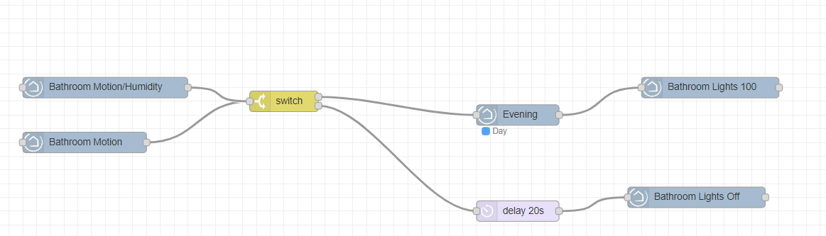

It's a simple motion lighting flow is what I'm trying to accomplish
If either motion sensor detects motion > turn light on.
Turn light off after no motion from either sensor after 20 seconds unless motion happens again.

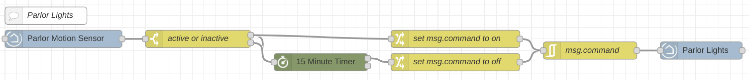

You could do it that way, but a lot easier way would be to use a stoptimer node, as it will automatically reset itself every time it gets a new message.
But if you wanted to do it with a delay node, just put a change node coming off of the ON branch of the switch node (or maybe after your "evening" node), going to the input of the delay node.
In the change node make it set msg.reset to anything.
That should work the exact same as using a stoptimer node.
Ahh, I see how that works now. Thanks for the help
