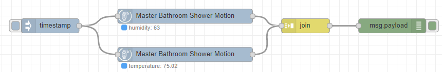

Here's the scenario. Simple test flow that sends two different attributes from the same device into a join node that makes a key/pair combination, then to a debug node.
What I find is that if I click the inject once, everything works fine. I get a combined payload.value as expected as seen below (notice payload.value has a humidity and temperature value).
If I click inject a 3rd time, the 2nd node 'object' gets another layer deeper. And etc for each additional time the inject node is clicked:
The only way to fix that 2nd node is to edit it specifying a different attribute and click done, or reboot node-red.
And here is what the msg.payload looks like coming straight out of the 2nd "messed up" device node. Notice the payload.value is now an object, as shown above - and has both humidity and temperature values in it!

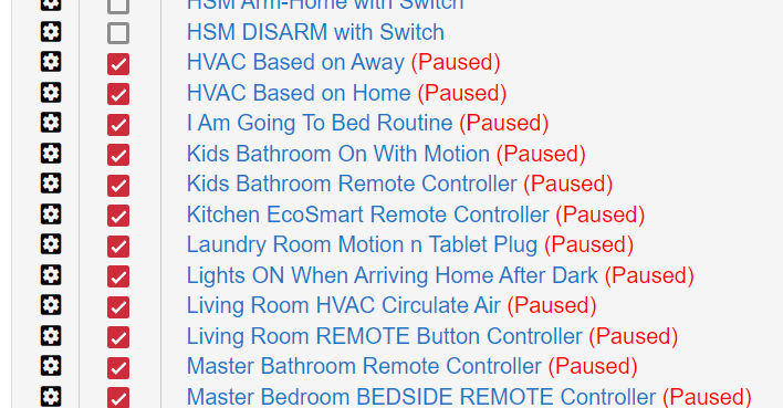

You mean that you didn't see this super-faded "X" that gives no clue what it is for?
When you click on it, you get the checkboxes and the "X" turns bright red.
You must not have watched the Hubitat Live stream tonight. They mentioned it and that reminded me. That's when I searched the difference between Pause and Disable and learned Disable is less (probably negligible) load on hub. It's also an option on the Devices page so you can disable devices w/out unpairing/deleting.
