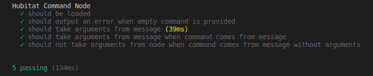

small new version 0.0.26
  • fix a regression that ignore arguments from message when command comes from message too (reported by @JasonJoel)
With this bug I added first unit tests to avoid such regression :tada: :smiley:
