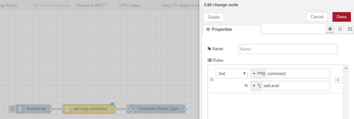

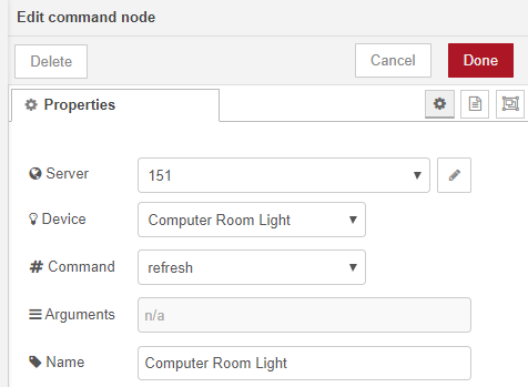

If I specify certain msg.command on an incoming msg to a command node (specifically commands that require an argument), it will fail (it doesn't send the specified arguments to Maker API).
On the Hubitat side I also see the error, and it is pretty clear that the argument never got passed?

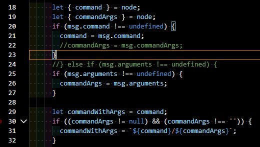

I edited the code as follows to correct from that version:
msg.commandArgs does not appear to exist so it always be null. This breaks in the scenario that @JasonJoel described above (ie command override exists but argument override does not)
Also including line 24 as an else if breaks in the reverse scenario. Converting that to a separate if allows all the scenarios I tested to work.
Edit: please note that my edits apply to 0.0.24..I have not looked at 0.0.25 so hopefully this still applies.

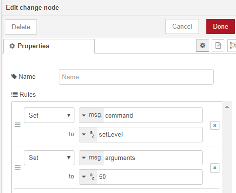

OK, I should have explained it differently. Even if I specify msg.command and msg.arguments it does not work - it omits the msg.arguments specified. Any time you specify a command that requires arguments in the incoming msg, it drops the arguments specified (in the msg.arguments or the node arguments entered).

@fblackburn, this is occurring because of line 22 of comands.js.
I believe what you meant to have here was commandArgs = msg.arguments
instead of commandArgs = msg.commandArgs
msg.commandArgs, and therefore commandArgs, will always be null so "setLevel" will always end up being sent with no arguments and cause HE to spit out an error.
