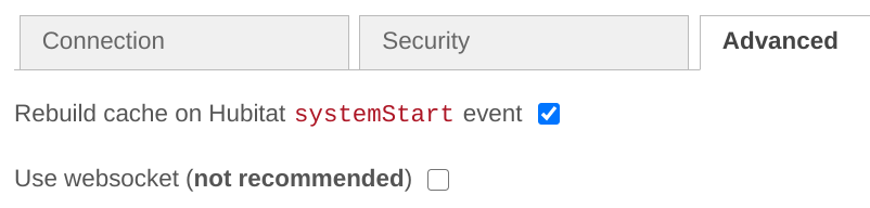

Are you using the websocket connection in node-red? It might not show up on that... Can't remember.
This:
No, webhook
You should receive event on reboot too. Which connection did you use? (webhook or websocket)

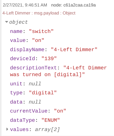

Definitely working for me on the current hubitat firmware and current node-red nodes on a DEVICE node. I did not try it on an EVENT node (EDIT: I did not, and type is on there too):
Now I'm really confused because it shows as expected now.
Yesterday I selected the "switch" attribute and the property was not coming through. Just now I tried the "all" attribute and it showed up as expected so I then selected the "switch" attribute and it shows up there as well. I must have done something different than I'm remembering.

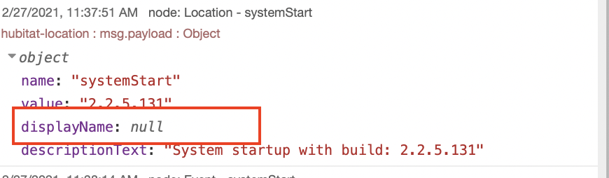

I just tested in my live and test node-red instances and the systemStart event is being published by the Event node and the Location node, so now I'm really confused as to why I wasn't seeing this before. I put logging at "debug" level in my test instance and saw that it was published. I then turned the logging level back to "info" and it was still published. Then I tested the event node and location node in my live node-red instance (without turning on debug) and confirmed that both nodes again published the events.
I now have to figure out why my logging database is not seeing the event. Sorry about the confusion.

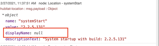

UPDATE: Figured it out - in my logging flow, I am filtering and suppressing a "null" displayName. All the other events have a displayName attribute but the systemStart event does not.
@fblackburn - Is there any value to adding something in the displayName attribute? Currently, the location event "sunrise" or "sunset" have "sunrise" or "sunset" in the displayName attribute and hence were being logged. If it doesn't make sense, I will modify the flow to account for this event.
Aah it's nice you figure it out :+1: :slight_smile:
Well displayName is not populated from NR, but come from HE directly. If you want to have a value in this field, you should make a request to Hubitat's team. But it's easier to update your flow, I guess :grinning_face_with_smiling_eyes:
