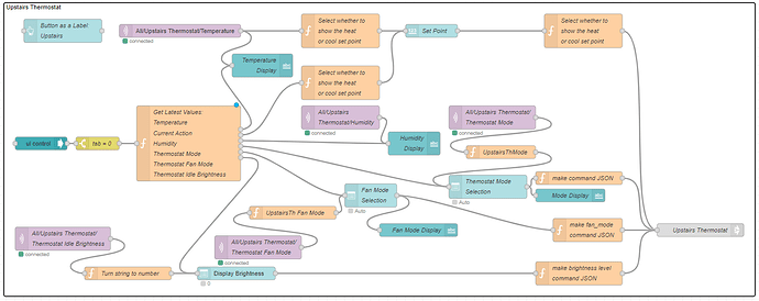

Just wanted to share something I just learned about something that can be done with a Node-Red Node's Name field. You can insert newline characters that will be reflected in the nodes display. Here is an example of my Node-Red Thermostat Dashboard where I was able to make my nodes much clearer to understand:

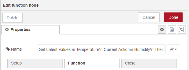

Here is the name field in the big switch-like function node in the middle:
As you can see to get a line break in the name shown for the node you add "\n " . Apparently for reasons discussed on the NR board, you must enter a space after the \n or else it will be treated as normal text.
As far as I can tell because it is in NR's implementation, it works for any node with a name field.

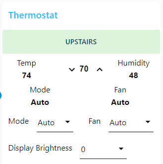

This flow plus some off flow data handling gives me this thermostat layout in NR, passes inputs back to Hubitat and updates automatically whenever updated at the thermostat or via Hubitat Device/Dashboard:
